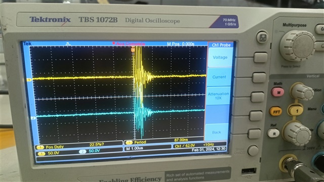

    It is unclear whether CVDD is falling due to the transient or if it is falling due to being turned off due to another pin. Using microsecond divisions instead of millisecond divisions, can you please capture the LDOIN and AVDD transient as well as a picture of the AVDD and CVDD transient. The millisecond division screenshots provided tell us some problem is occurring, but it is not explaining how it is occurring.
    Referring to one of the DVDD and TSREF images:
    In this picture, the HV contactor does not appear to occur when DVDD falls down. This is why we need to identify the original pin causing the issue so that the fail mode can be explained.
  • Hi David
    Please see the below waveform taken on CVDD and AVDD lines.
    Blue - Waveform of AVDD
    Yellow - Waveform of CVDD
    Thanks and regards,
    Ramchandra Bhosale
  • Hi Ramchandra,
    I am currently discussing this issue with the FAE. With the image provided, the issue is that the large spikes are due to ripples in the GND plane's voltage. This is why the spikes can be seen on so many of the IC pins. These transients cause the voltage supplies to significantly exceed their absolute maximum ratings which will reset the IC. As the IC is not rated for such high +/- voltages, it is expected for the IC to not work due to these transients. This noise needs to be mitigated before it reaches the IC. I've directed additional questions to the FAE which are:
    1. Are there any long cables that may be introducing parasitic inductance? Inductance/inductive loads is a significant cause of HV transients.
    2.Is there any additional external filtering near the battery pack or battery pack load?
    3. Are there TVS diodes closer to the battery pack or load?
    At the end of the day, the transients on DVDD, AVDD, and CVDD will collapse the power supplies and cause the IC to reset. The cause of these transients needs to be identified and then a plan to mitigate the cause should be determined. I will continue discussing with the FAE.
