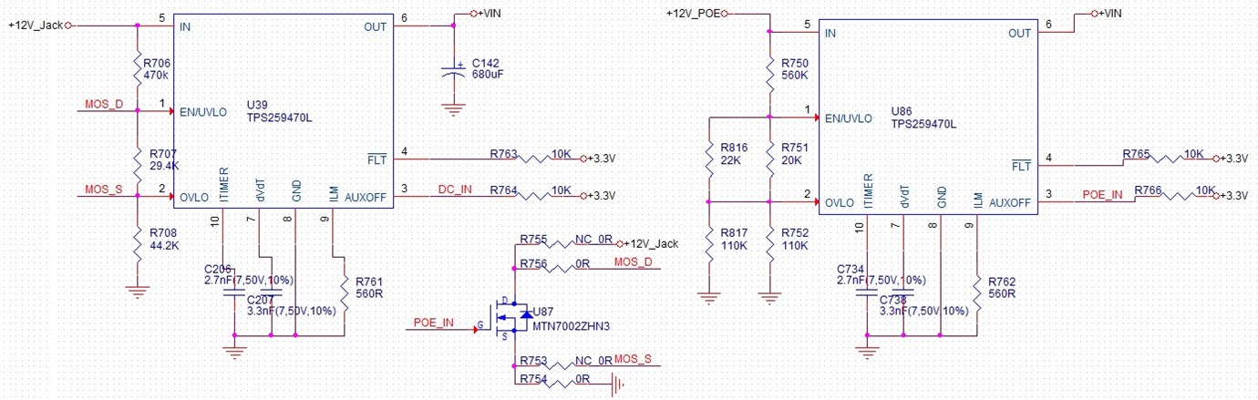

TPS25947: burnt phenomenon on GND path
Part Number: TPS25947
Hi Sir,
My customer used the TPS259470L to do the power MUX application, they found has the burnt phenomenon on GND path.
I am not sure the IN/OUT pins have not added any vias, is it a root cause?
Could you please help to review the schematic and layout? if it needs to modify, please advise it. Thanks!
TPS259470L_layout:
TPS259470L_layout.docx
