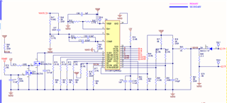

Find the circuit diagram Below.

    Do you think Q13 is pulling SS low?  I would try disconnecting it from the circuit just to see if it removes the issu.
  • I had similar doubts, so I disconnected R74, R76, placed 820K across SS capacitor to make it like a standalone device. Still SS shows low. Randomly Controller is turning ON, like one in 20 times. Sometimes if leave device turned OFF for longer time, then it's turning ON. Random behaviour.
    If the device is running in follower mode the design  needs an 820 k ohm resistor to ground.  Otherwise the device could enter a test mode.
    How about tying the gate of Q13 gate to ground and using the 820 kohm resistor on the SS pin and retesting.
  • Q13 is removed, controller Video gameis working.
    Will try fixing Q13 at later stage.

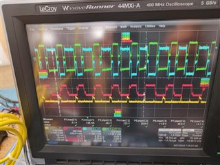

    Now, controller is turned ON, set input to 22V, synchronous FETs are in diode mode. below are observations:
    1. Waveforms at drains of Qc, QD. There is that burst type of outputs, which was not observed on QA, Qb leg. Is that how it's supposed to operate??
    2. Below is the peak observed at drains @Vin : 20V
    Also there was some noise starting which I suppose should be switching noise.
    Yellow is the output regulating to 2V. Is that peak as expected? How to avoid ?

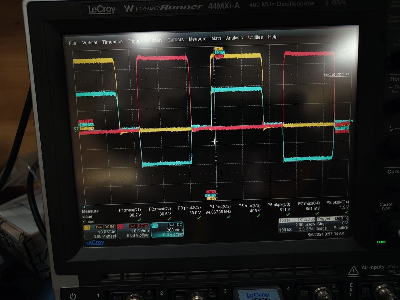

  • 1. The thing which I noticed about synchronous FETs as per 600W design is , when transformer winding 1-3 is on positive side, Q5 is OFF, Q6 is ONN.
    Yellow: Q5 drain to source
    Red : Q6 drain to source
    Blue : transformer pin 1 ( positive probe ), pin 3 ( negative probe )
    So When Qa to QD is ONN, outF should be ONN.
    Qc to Qb is ONN, outE must be ONN.Verify and  Confirm from your end??
    Does the synchronisation  direction should match  with transformer postive and negative or we can just connect outE and outF random??

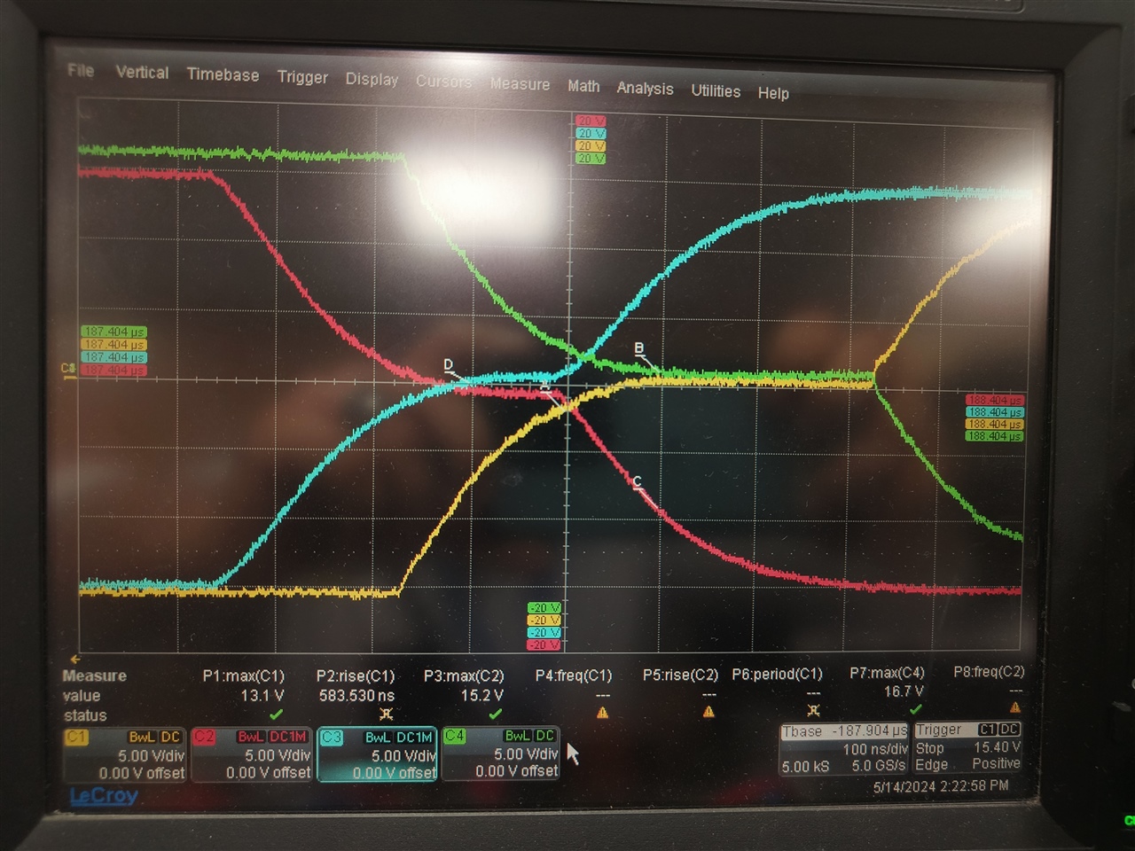

  • Below are the switching waveforms.
    I'm observing outD before outA, is this ok ?
    Yellow : OutA
    Blue : outD
    Green : outB
    Red : outC
    These look like the voltages at the gate of FETs A through D and not the output from the UCC28951 directly.
    If this is the case the waveforms look good.  also note there is not an exibit of the miller plateau which means your design is zero voltage switching.
  • Yes, you're correct, these are gate switching pulses. I have not applied Vin yet. Just wanted to confirm gate voltages before proceeding to apply Vin.
    Thanks for letting me know.

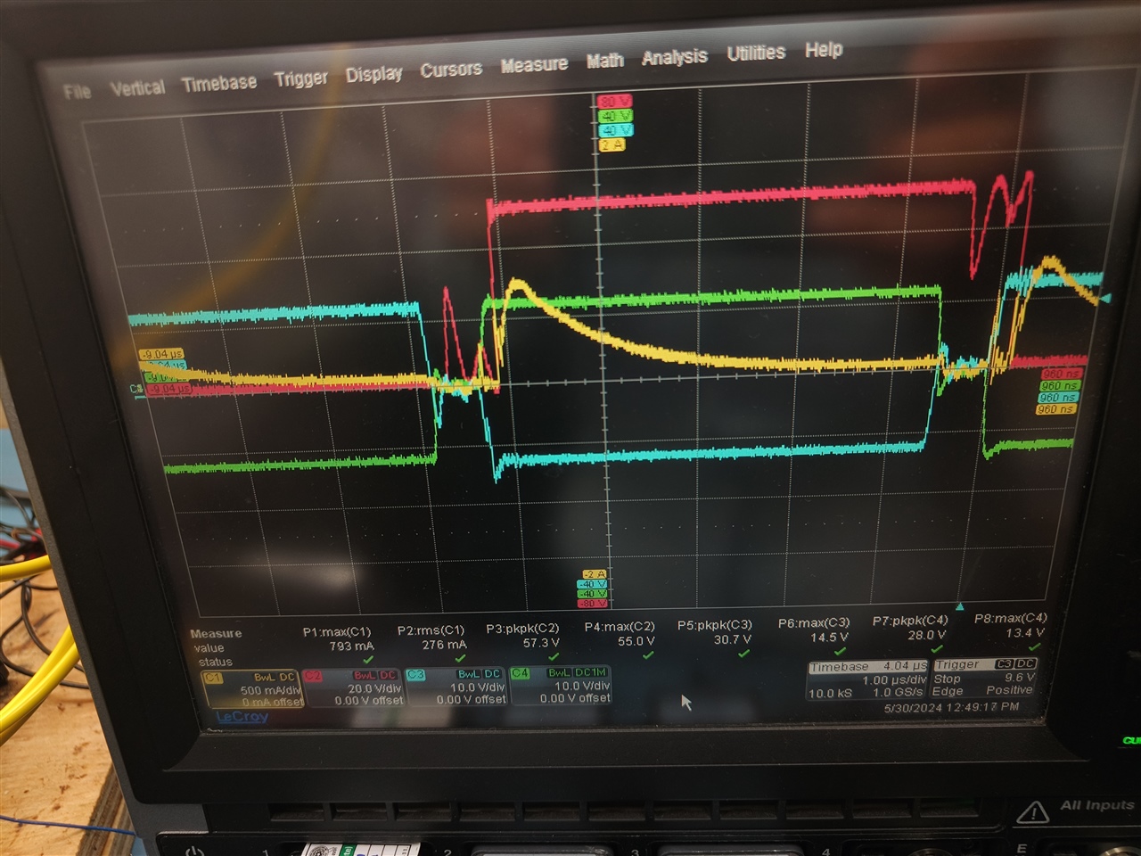

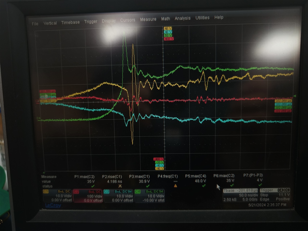

  • Have applied Vin: 50V,
    Below are the drain to source voltages of Qa, Qb. I'm seeing huge peaks . Any reason why could this be happening?
    Though diodes are present, why are they not suppressing Peaks? Any suggestions?
    FYI, its No Load, synchronous rectifiers are in diode mode.
    Mosfet p/N: IPW65R090CFD7XKSA1
    Diodes: GD02MPS12E
    You might want to study the gate drive of the FETs along with the drain voltage while this is happening.
    You also might be just picking up stray noise from your scope probe grounding.
    I would try looking at this tip and barrel across the drain to source of the FET to see if things improve.
    You also might want to use a ferrite toroid to form a common mode choke on the scope probe wires.
    I believe there is instruction how to do this in the EVM users guide.
    https://www.ti.com/lit/pdf/sluu421

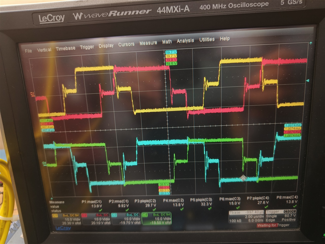

    Vin : 25VDC
    Gate drivers: 15Vdc, controller: 12Vdc
    I tried connecting same film capacitors to the other side of current sense, near to drain of FETs, I don't know whether it's a good idea as per the topology, you can comment on this. The capacitance is ( 75nF || 0.5uF || 22uF ). What happens is gate waveform of D has become much better, but gate of C has ringing and dip near Miller region which in turn effects it's drain to source voltage.
    Additionally The spikes of drain to source of C is very high.
    Is the ZVS not Kicking In ? Should I add series capacitor between shim inductor and transformer ? Please suggest.
    Refer below image:
    Yellow: C gate
    Blue : D gate
    Red: drain source of C
    Green : drain source of D
    Gate waveform of C with dip shown below:
    Yellow : gate of C
    Green : drain to source of D
    Your inquiry has been received and is under review.
    If your gates to your FETs are ringing have you tried adding a resistor in series with the gate drive and the gate of the FET?  This should help with damping the ringing of the FETs at the gate drive.
    You have the drain of FET ringing well above the input.  I am not sure how this happens the body should conduct before this happens.  So this does not seem correct or real.
    I would double check this tip and barrel around directly across the drain and source of FET D.  You also might want to rap the scope probe wire from prop to scope around a ferrite toroid.  This will form a common mode choke and remove common mode noise from the signal.

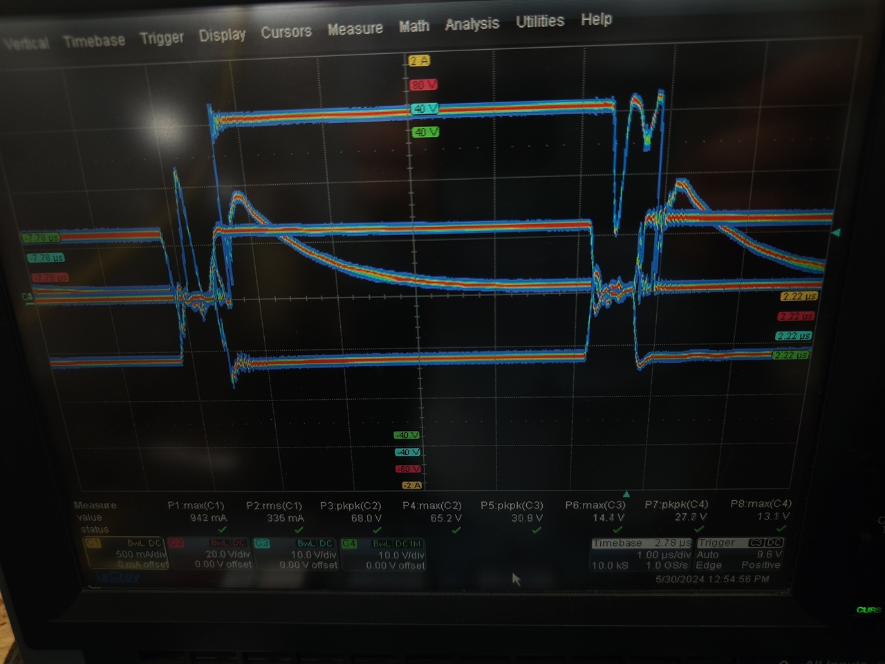

  • So the ringing is reduced with some modifications.
    Vin voltage :26V, gate drive transformer voltage: 15V, frequency: 80khz
    1. Using gate drive transformer with 560uH inductance
    2. Using 4.7nF film capacitor across drain to source of each FETs
    3. Gate resistance is around 110ohms
    4. Added diode ( reverse direction) across gate resistor for turn oFF.
    Below is the image of switching nodes ( transformer leads )
    Questions:
    1. Since I have made above changes , lemme know what all changes are acceptable?
    2. Additionally adding external capacitors across drain to source ? Can it be added ? Can I compensate that capacitor discharge with addition of shim inductor? Please advise. As of now shim inductor is not connected
    3. Can I try adding some series capacitor with shim inductor? Will it help in any way ? If yes what values to start with ?
    4. I have added ( 75nF) on the other side of CT transformer, direct to mosfet drain and source. is this acceptable? This is done to reduce huge peaks. Will this disturb the cycle by cycle current sense in the controller??
    Next changes:
    updating frequency to 100kHz
    Reduce gate drive transformer voltage to 12V
    Adding series resistor of around 10ohms to reverse diode
    Your inquiry is under review and I will get back to you shortly.
    It seems like you are heading in the right direction.
    Please see my comments below.
    Questions:
    As long as you understand what you changed and why changed it you should be O.K.  However, you should back your design up with reliability and production testing.
    It is not uncommon to add capacitance from the switch nodes to ground on the primary.  Some designers do this to control the tank frequency.
    If you are trying to dampen ringing you can always add RC snubbers across the FETs.
    You actaully can add RC snubbers across the shim inductor to dampen any ringing.
    75 nF is quite large for a capacitor across the CT.  Generally you can reduce the noise from the CT output to the CS pin with an RC low pass filter for the current sense resistor.  Typically designers use 1k to CS and 22 to 220 pF from CS to ground.
    I do have a word of advice.  For every change you make, you should compare a before and after.
    You could have noise on the secondary that is coupling through the transformer to the primary from the secondary.  You can add snubbers across the SRs and/or transformer.
    Lastly you might want to try relaying out your power stage to reduce noise.  Keep you power loops as short as possible.  1 in of trace adds 10 nF of inductance.
  • Thanks for the inputs.
    I disconnected transformer, it's open circuit just bridge and gate pulses. What I noticed is it's still drawing current From DC source and slowly increasing. I had restricted it 200mA, it was reaching 200mA within some 10 -12 seconds.
    I removed bottom fets of each leg separately and checked , it's not drawing current.
    the current drawing is because of shoot through is what I have understood till now.
    FYI, Gate pulses of same leg are opposite in direction. SO GATE PULSES are Ok. A & D switch together, B & C switch together.
    Layout wise I don't see any issue as such.
    Any idea what could be the reason ?
    C and D are phase shifted.  I would double check to see if there is any over lap making the design draw current.
  • Gate waveforms are phase shifted as per the design.
  • I disconnected the full bridge. Connecting only one half bridge and checking. Soldered Mosfets outside of the board on a bread board. Though I restricted the current to 0.7A, it was still drawing current approx 0.65A . I suspect there is still some shoot through current. I read in the forum that CT helps prevents shoot- through? How it helps ? Anything I need to check with CT, Rtmin or any other variable??

  • Thanks for the inputs. Few queries
    1. I have seen primary FETS failing particularly C, D, and twice C. Below is the board scenario.
    The SR FETs were updated to FETs from diode mode. Put back gate resistor, gate to source resistor.
    DELAB, DELCD :50K
    DELEF: 70K
    When I was slowly varying DC supply around 50VDC, FETs were failing, mostly gate to source was getting damaged, drain to source channel was OK. No shoot through currents observed.
    Also output side , windings are parallel, output capacitance is around 21000uF. Could there be any impact of secondary side FETs turning on due to huge inrush current and damage FETs. It's a theory I have arrived, you can infer and tell your opinion on this.
    Below is a waveform where I see drain voltage dip for momentarily
    Blue and green : gate waveforms C, D
    Red : bottom side FET
    Yellow: input current

    4. Vin : 200V, DC source current : 270mA, diode mode Fets at output, Load current : 1A, Tmin:12K
    Below are the waveforms. My observation is approx every 52.3 uS , there is negative current which is probed at the primary side of CT, gate pulse width of C and D is also reduced at that instant. Your thoughts on this
    blue, green : gate waveforms
    Yellow: Primary CT current
    Pink: C drain to source.
    Zoomed version
    5. When i Increased Tmin: 33k,
    Case A; Load current: 1A, DC source current: 220mA
    The previous reverse current peaks visible in Yellow channel were not present.
    Blue: Gate source of C,
    Green: C gate before pulse transformer
    Pink: Drain source of C
    Yellow: Primar Current CT
    Case B; Load current: 2A, DC source current: 380mA
    The previous reverse current peaks visible in Yellow channel were present, but small. Here Some audible noise started appearing. below is the waveform. Gate drive transformer negative side doesn't look Ok. Your comments.
    Zoomed out Version below

    There was no ON time between D & A. Then I started probing on D waveform tracking in from controller to gate of FET. No issues were observed on the burst mode. All waveforms were 50% duty cycle.
    When I tried to load it with 1 A -2A current, I was facing this issue. And sometimes D waveform was so small, that it was not at all 50% duty ratio. When I probed further, what I also observed is transformer primary current, I'm able to see that 2mH charge , i.e.  but the other leg, negative side it's not charging, it's dropping very sharp, that shouldn't happened with 2 mH inductance. Then I suspected something at the output, I removed FETs replaced with schottky diodes. Diodes are placed in same direction as MOSFET source to drian diodes. Cathode of both diodes is connected to other two windings.
    still transformer primary side positive is charging, negative side, it's sharp transient. Below waveforms are available for understanding.

    Blue : C
    Green : B
    Also see the below image where transformer and primary CT currents have been captured. There is no negative side current.
    Green : primary CT
    Yellow: transformer
    Blue : switch node voltage.
