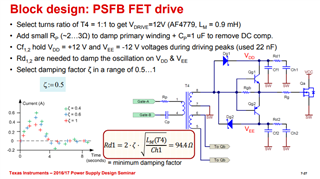

1. Planning to use gate drive transformer for both the models.
below are calculations for the same. Kindly review and advice
Steps Parameter Value Unit Remarks
1 Peak Voltage (Vpk) 15.00 V Gate driver voltage
2 Min Switching Frequency (Fs) 98000 Hz Datasheet - UCC28950, excel design doc - SLUC222D
3 Time Period 0.0000102 S T=1/f
4 Max Duty cycle ( nominal ) 0.70 % Datasheet - UCC28950, excel design doc - SLUC222D
5 Ton 0.00000714 S  Max duty * Time period
4 Calculated ET 0.00010714 V-S
  Calculated ET ( micro ) 107.14 V-uS
5 Calculated ET for bipolar 214.29 V-uS Ton=2*ET/Vpk, for Bipolar drive
6 Source Current Of Gate drive pin 1 A Datasheet(UCC27324P)
7 Inductance Required 0.0001071 H Ipk=UpkDmax/(Lprim,min*fmin).

3. selected gate driver for now GT04-111-315-B
    1. Your input range for both designs is 3 to 1 or less.  The excel design tool referenced in application note SLUA560 will be to calculate the required transformer turns ratio, output inductance, output capacitance and all other power stage components.  This information was used to design the 600 W evaluation module.  It sounds like you used these tools in your design.  Please note the transformer turns ratio for both designs will be different and can be calculated with the excel tool based on the input and output power requirement.
    https://www.ti.com/lit/pdf/slua560
    2. If your design is running in CCM per your duty cycle will change with input voltage and not load.  This is how application note SLUA560 recommends that you do the design.
    3. When it comes to the gate drive transformer check the transformer to make sure it can handle the peak, rms current and can operate at your desired switching frequency.
        I reviewed the data sheet for the gate drive transformer and it is rated for 300 kHz and is high pot tested up to 4.5 kV.  It looks like it should work.  However, double check with          the manufacture to make sure it can handle the peak and RMS current you will be driving through it.
    The rest of your specifications look reasonable and accomplishable.

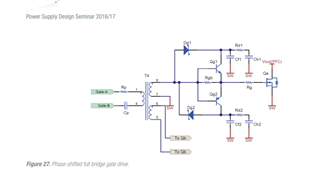

    1. I happen to come across this document (Design review of a 2-kW parallelable power supply module (ti.com)), attached image shows gate drive circuit design. Comments on circuit.
    2.  Also If I'm driving silicon carbide FETs using Pulse transformer, I have to restrict VGS to +15V, -5V, is it possible to restrict SIC FETs using this Pulse transformer method ? if Yes, How ?
    3. Read these documents
    Design review of a 2-kW parallelable power supply module (ti.com) ( Pg 22 ),
    https://www.infineon.com/dgdl/Infineon-GateDriverIC_EiceDRIVER_isolated_gate_driving_solutions-ApplicationNotes-v01_01-EN.pdf?fileId=5546d462700c0ae60170a0c4af851028 ( Pg 6 - 7 ),
    Not able to draw conclusions. why because All most all the Eval boards I have seen both from TI and Infineon , They use Pulse transformer even if the wattage is upto 3 KW. Kindly advice on the robust solution so that i come out of the gate driver design loop and focus on the other design aspects.  Kindly advice whether to go ahead with Pulse transformer ( which most people call it yesterdays solution ) or should go with Isolated gate drive. Give me an argument i can't refuse with reasonable assessment Innocent

    1. The high side drive looks like they are using a PNP/NPN totem pole driver on the high side FET.  I have seen this used before and it should work.  You should be able to drive these FETs directly with a gate drive transformer as well.
    The benefit of the discreate totem pole driver is it is a discreate driver and will not load the gate drive transformer as much as directly driving the high side FET.
    2.  When it comes to driving SiC FETs in an H Bridge you might be better off using isolated gate drivers.  The UCC21551 is an isolated high side low side driver for SiC FETs.  The following link will bring you to the data sheet for this device.  If you have questions in regards to using the UCC21551 please repost in the e2e with UCC21551 in the thread title.
    https://www.ti.com/lit/ds/symlink/ucc21551.pdf
    3.  I have seen both gate drive transformers and high side/low side drivers used in phase shifted full bridge converters.   The following link will bring you to a phase shifted full bridge design that uses isolated gate drivers vs a gate drive transformer.
    https://www.ti.com/lit/ug/sluub02a/sluub02a.pdf
    It uses to be in high voltage applications you would require to use a gate drive transformer to drive the high side FETs in a half bridge or full bridge.  This is because the FET drivers could not handle the voltage.  However, today with improvements in process and the development of isolated gate drivers, Integrated FET drivers can be used instead of gate driver transformers.
    The benefit of using gate drivers is less circuitry required to driving the high side FETs.  With gate drive transformers you will require a DC blocking capacitor, DC restore capacitor; as well as, protection circuitry to ensure the FETs gates maximum +/- voltages are not exceeded.

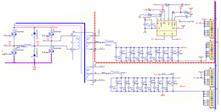

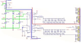

  • Moving on to the other Question:
    On the Secondary side of Transformer winding, i'm Planning to have 2 secondary windings. (shown in fig)
    Reason being, I have to make two models. 12V Variant and 24V Variant.
    The 2 Secondary Windings Will be of 12V and feedback will be taken from One winding.
    For the 12V version two separate windings will be connected in parallel from outside connector.
    For the 24V version, Two secondary windings in Series from the Outside Connector.
    The top secondary winding Will have separate ground. For that I will have a separate isolated power supply and Gate driver. OUTE and OUTF Will be connected to Positive and negative side of Transformer Top side secondary winding. Similarly, to the Bottom secondary winding.
    Your thoughts on this..
    Your inquiry is under review and I will get back to you shortly.
    If your are designing a traditional PSFB you will either do a current doubler or a voltage doubler.  These designs would require a center tap transformer on the secondary.
    I think you are thinking of what you would do with a traditional forwarded converter.  I believe you can still do the same thing with a multi tapped transformer.
    The other option is to use a full wave rectifier on the output instead of SRs.

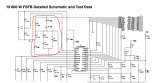

    The other question is on Loop compensation.
    I did read the document ( https://www.ti.com/seclit/ml/slup348/slup348.pdf?ts=1702982818805&ref_url=https%253A%252F%252Fwww.ti.com%252Fproduct%252FUCC28951 )
    and thread ( https://e2e.ti.com/support/power-management-group/power-management/f/power-management-forum/1008296/ucc28951-q1-tuning-of-error-amplifier-of-voltage-and-current-control-loop
    My Load current requirements are : No load,  Minimum Load : 2A, Maximum Load : 90A
    But there are different loads ( DC coils, DC heaters, etc )  connected at output drawing different load currents at different instances.
    In that scenario, will the normal Type - I compensation work or we need a different strategy here. Please advice.
    I am reviewing your inquiry and will get back to you shortly.
    I think type 2 compensation should work for your design.  That is what your slide shows.  This compensation has two poles and zero.
    Generally type 3 compensation is generally used in voltage mode control.  This is to deal with double pole in the transfer function that is seen by the output filter pole.
    You had mentioned that your loads are coils.  I am not sure if there is an effect on the control to output transfer function.  You might consider putting place holders for type 3 compensation just in case you need it.
    It is always a good idea to check your compensation with a network analyzer and adjust the loop as necessary.  Some designers prefer to setup the voltage amplifier feedback into an integrator and measure the control to output transfer function and then compensate the voltage loop.
  • When you say Type II compensation or Type III compensation, I will do something similar to what is done in the 600 W App note, with component values taken from my excel sheet. correct??
    What you have circled is type II compensation.  If you populate R28 and C8 you you will have type III compensation.
    Please note that the excel spread sheet is setup for type II compensation.
    The following link will bring you to a paper that discusses the difference between Type II and Type III amplifier compensation feedback.
    I believe you will find this paper helpful in your design efforts.
    https://www.ti.com/lit/an/slva662/slva662.pdf

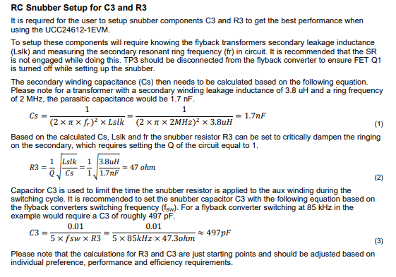

  • Ok. Moving on, Suggest me design for Snubber circuit on the Synchronous rectifier MOSFETs.
    The following information was for setting up snubbers across SRs in flyback converters.  However the technique and math for setting up the snubbers in SRs is similar for a PSFB.  You should be able to use this information to setup the snubber on your SRs in your design.

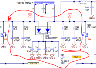

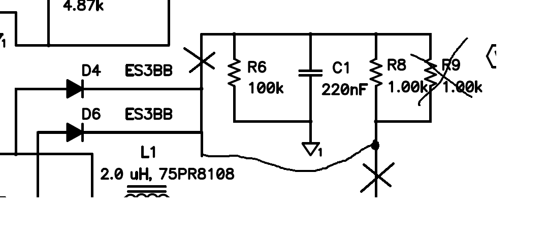

  • I was going through EVM (600 w) and (PMP8740 2kW) designs, both have used RCD snubber.
    can you guide something related to this type of design, like calculating components values, etc.
    Also, what do you suggest?
    Regards.,
    D13, C64, C74, C75, C76 and R98 form an RCD clamp.   I do think there is a better way to setup an RCD clamp for this application.
    The following link will bring you to an e2e thread discussing how to setup and RCD clamp for this application.
    https://e2e.ti.com/support/power-management-group/power-management/f/power-management-forum/1132532/ucc28950-ucc28950-senkron-rectf-snubber-question/4202839?tisearch=e2e-sitesearch&keymatch=UCC28950%2520Clamp#4202839

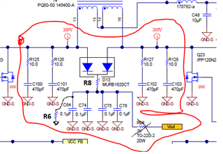

  • Ok. There is some confusion based on what you're suggesting in the link. R8 another end will be left unconnected, R6 and C1 other end where it should be connected??
    1.Can you please draw and share.
    2. Where should Vout be connected?
    3. Some formulas are valid, and some have changes. Can you mention the list of formulas which are correct and can be utilized?
    4. Should Both diodes be selected based On Iout ?
  • .Hello,
    Answers to 1 and 2.
    In the post they are using and RCD clamp.  It is not connected to the output.
    I have marked up your schematic to show where R6 and R8 would be placed.  R98 would be removed.
    3. Which formulas in the post are not valid?   Are they clarified and correct in the post?
    4.  The current that goes through the diodes is the current that is present in the leakage inductance when the FET turns off.  The actual current in the SR when the FET turns off is (Iout - (Change in ILout/2.)  Using Iout is an over estimate but O.K.  Over estimating is O.K. when setting up the clamp.  Under estimates is where you will run into issue.

    The purpose of an RCD clamp is to protect the FET from an over voltage caused by the leakage inductance energy and ringing that may be present on the switch node.  So when the FET turns in this application 2XVout will be stored across C74..C76, and C64.  Resistor R8 is used to dissipate the magnetizing energy and protect the FET from an over voltage when the SR FET turns off.
    The power dissipation in R8 in the traditional clamp would be cause by the secondary leakage inductance.
    Pslk= ((Llsk/2)*(Iout)^2)*fsw
    If you use the clamp with R98 tied to the output the power dissipation of the resistor would be ((2*Vout)-Vout)^2)/R98.  This clamp will work well but most customers find that it dissipates too much power.
  • Ok.
    1. Regarding The equation of PSlk, since the output inductor frequency ( 2 • fsw ) will be twice that of operating frequency , in my case ( fsw: 100kHz ) , so the equation should be fsw or 2•fsw ??
    2. During operation this process of charge and discharge would be continuous, and the only way to discharge each cycle is thru R6. Is 100k a good value to begin with ?
    Please see my comments below.
    > Even thought the inductor is seeing 2*fsw the switch is not.  It is switching at fsw.
    > R6 is meant to discharge the capacitor every switching cycle to ensure that capacitor does not creep up above 2*Vout.  A 100 k should be fine.

    Can you show me a schematic of the transformer and output circuitry for this design?
    After reviewing your schematic and seeing that you have two center tapped secondary windings, you are correct in regards to selecting your output inductors for this design.

    5. Planned to drive above two Centre-Tapped secondary windings in the below manner.
    FYI,
    Vout1+, Vout1- : top winding
    Vout2+, Vout2- : Bottom winding
    Vout1+ is the supply which is generated during startup phase with no load conditions, i.e. When OUTE, OUTF are disabled. Vout1+ will be the bootstrap supply. Please let me know if any changes.

    1. Please evaluate the design mentioned in the 5th point.
    2. When you say for low power it's Ipp/2, it's already Ipp/2 in the equation. Further I should do ( Ipp/2 )/2.  Please clarify.
    3. I want to achieve ZVS down to burst mode or light load conditions, what will be equation or value to be considered?
    4. For the shim inductor selection, the value is 13.62uH from excel. Should i keep the same value as per above design which I have implemented or it needs to be doubled or halved . As you can see the design with two center tapped secondary windings design?
    > Your schematics look to be functionally correct.
    > You can use the excel design in the product folder to check the power stage and controller setup.
