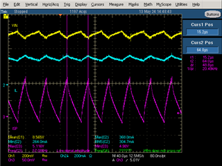

We are facing some issues related to TPS552882 and found that the output voltage ripple is large and there is obvious part noise under heavy load.
Could you help identify if there is anything that needs to be improved in our design?
Thanks.

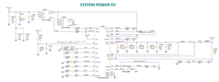

Schematic(Vin:5V to 9V, Vout:5V)

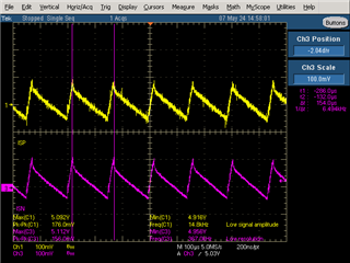

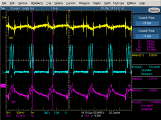

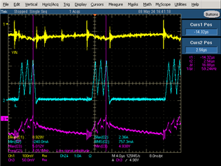

We use the power supply to provide a voltage of 9V and get the following waveform. The voltage ripple is large under heavy load.
Waveform(lightload)
Waveform(heavyload)

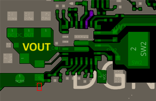

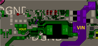

Layout

  • Hi Boris,
    Thanks for reaching out.
    It looks like the stability problem regarding to the large ripple during heavy load. Please share the ESR value and part number of the output capacitors (C2907-C2910)? So we can check the compensation parameters.

  • Hi Boris,

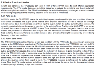

    Sorry to miss the voltage level label of Vout waveform on heavy loading, it is still on PFM operation with the ' heavy loading' condition, so the voltage ripple is large.
    I have checked the compensation parameters, it looks good with the current COMP parameters.
    Please add more loading on the output side, when the device enters CCM from PFM, the voltage ripple will be much smaller.
    If you want much lower voltage ripple all all load conditions, you can change the resistor R2915 to 0ohm to select FPWM. And there also will be no noise. The drawback is the efficiency will be lower at light load compared with PFM.

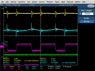

  • Hi Bryce,
    After observing the waveform, we noticed ringing on the ripple in the heavy load and are seeking a solution to address it in the power path.
    Boris
  • Hi Boris,
    To capture the output voltage ripple, it is recommended to use the ground ring to probe the voltage as below and use only one channel voltage probe to forbid interference from other channels.

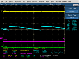

  • Hi Bryce,
    Thanks for your information. I have one more question.
    After removing Rsense(R2904) and shorting it, the noise from the power supply components disappears, but we still require current detection functionality for protection against excessive currents. Do you have any suggestions regarding this issue?
    • Install Rsense
    Install Rsense
    • Remove Rsense and short it.
    Remove Rsense
    Boris.

  • Hi Bryce,
    Consistent results were obtained when measuring the waveform in CC mode using a single channel.
    We would like to know why it will change the frequency and the ripple will decrease when we short it.
    Do you think adding a Pi filter between ISP and ISN would help solve this problem(the noise of components)?
    best,
    Boris.
  • Hi Boris,
    Do you test at the same loading condition? Because from the above load current waveform, it seems the output current is not the same value. I don't think shorting and un-shorting the output current sensing resistor have that big difference on output voltage ripple frequency at PFM.
    I am not sure if the noise is introduced by the test of different voltage probe channels, please use only one voltage probe on Vout to see if the noise still exists.

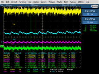

  • Hi Bryce,
    Using a single channel to measure the ripple yielded consistent results as previously noted.
    While bypassing the current sense resistor resolves the issue, maintaining the current limit function necessitates its retention.
    • With Current sense
    • Without Current sense
    Boris.
  • Hi Boris,
    Thanks for feedback.
    But I don't think shorting and un-shorting the output current sensing resistor could have that big difference on output voltage ripple frequency at PFM, can you also probe the inductor current waveform by inserting a wire between the inductor and the SW2 pad like below?
    Do you test with the electronic load at CC mode? Because with different loading current, the voltage ripple frequency will vary much.
    BRs,
    Bryce

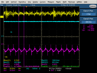

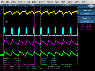

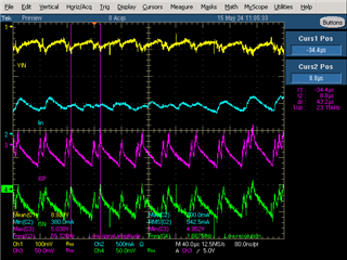

  • Hi Bryce,
    The measured waveform is as follows, with our load being the device itself rather than generated by the electronic load machine.
    • With Current sense (zoom in)
    Install Rsense(Zoom in)
    Remove Rsense
    Remove Rsense
    Boris.
  • Hi Boris,
    Thanks for the waveforms.
    From my understanding, it doesn't make sense the output voltage ripple and inductor current waveforms show that big difference, it is more likely the device is operating at different loading.
    1. Could you try to change the output sense resistor to 5mohm? Will the output voltage ripple frequency also change?
    2. And what about adding one ceramic capacitor (1uF or 0.1uF) at the ISN net like below?
    3. Can you try with electronic load at CC load to see if any difference?

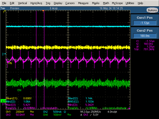

  • Hi Bryce,
    After switching to CC mode, the test results remained unchanged.(see the waveform)
    The addition of either 1uF or 0.1uF at ISN similar results.
    Once we receive the current sense with a 5m ohm from the supplier, we will conduct further tests and share the results with you.
    • Install current sense
    Install Current sense
    • Remove current sense
    Boris.

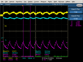

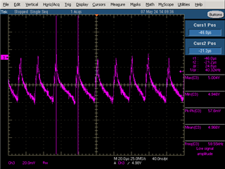

  • Hi Bryce,
    When switching the Resnse to 5m ohm resistor, the resulting waveform exhibits a halved ripple size and doubled frequency.
    However, the waveform appears to exhibit instability, raising questions about the reasonableness of this outcome.
    • Install current sense(5m ohm)
    Install 5m ohm Rsense
    Boris.
  • Hi Boris,
    It is not the instability problem, it was due to PFM mode operation at light load. The only thing which confused me is the frequency of output voltage ripple varies with the Rsense value at PFM.
    Would you select FPWM for smaller voltage ripple and constant output voltage ripple frequency?
    BRs,
    Bryce

  • Hi Boris,
    Below is the test result based on EVM. They show no difference on output voltage ripple frequency. So currently I think it is more related to the layout especially ISP-ISN and PGND-ANGD.
