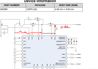

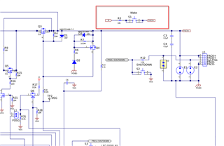

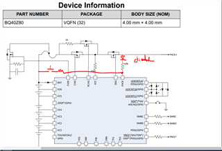

BQ40Z80: BQ40Z80: PACK pin relation to wake-up/shutdown of chip
Part Number: BQ40Z80
I have question related to the use of PACK pin to recover from Shut down mode. I am designing a button circuit to pass the Battery (Cell) voltage to PACK pin to recover from shut-down. However, I need to isolate my circuit from the main discharge output. Can I have a series diode to the 10kOhm resistor to PACK+ pin as shown below:
