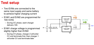

Hi ,
I am planning for paralleling two Bq25750 . One is powered with Solar (600W) another is with Wall adapter (240W) to charge the battery with 58 v , 10 A . Hereby , I am sharing the block diagram with you . Kindly , let me know the possible ways connecting them parallel.
