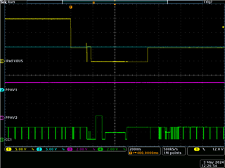

I have encountered an issue with our TPS65987D application in which a spurious reset is observed following receipit of RDO message requesting change from a 15V PDO to 5V PDO.
Configuration as follows:
  1. TPS65987D operating as DRP acting as SRCto provide power to an Apple iPad. Upon USB-C connection, the iPad selects 15V PDO (SRC via PPHV1) and charges as expected.
  2. Once the iPad reaches 100% state-of-charge, in some instances, the iPad is observed to send an RDO message requesting switch to the 5V PDO (5V, 0.5A in our applicaion, SRC via PPHV2).
  3. At this point, it appears that an over-voltage condiciton is detected on VBUS, and the link is reset. Please see attached oscilloscope trace.

  1. Oscilloscope trace showing VBUS and CC1 traces at point of RDO and subsequent reset.

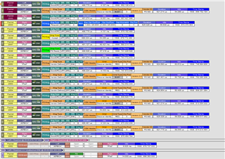

  2. Screenshot of LeCroy capture showing RDO message and subsequent reset.

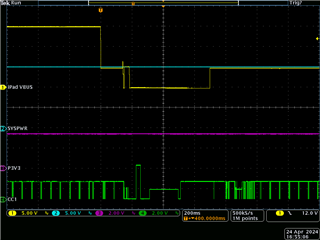

    2. In the scope trace originally provided, the cyan trace labelled 'SYSPWR' is the analog waveform on PPHV1. I do not have a capture of PPHV2, however this is connected to a locally regulated 5V supply which dervied via a boost converter from the P3V3 trace (purple). Please let me know if a capture of the PPHV2 net is still required (I'll need to instrument the board and re-produce).

    I have performed the expeirment again and captured the voltage on PPHV2 (locally derived 5V rail). Please see attached waveform 'tek00000.png' - no excusrion on this net is seen.

    We have a LeCroy Mercury T2P that can be used for PD traffic analysis. There's a screenshot of the output in the initial post - please see zip archive attached to this post (it's a relitively long capture as it was necessary for the iPad to reach 100% state-of-charge prior to chaning from 15V -> 5V)LeCroy capture.zip.

    Also I noticed in the Lecroy PD logs a couple parts I want to clarify with you:
    1. FR Swap occurred at packed 2065-2067, is this scenario intended and feature supported on your device?
    2. At Packet 2082 the iPad is advertising source cap and Jerboa is the sink, is your system booting up from a dead battery scenario and if so how is the dead battery flag being cleared?
    3. After the PR Swap at packet 2090, is SYS_PWr always at 15V? Is there ever a time where SYS_PWR is not present?

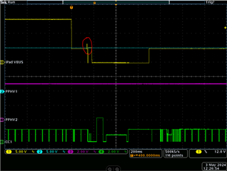

    After another look another suspicion is possibly OVP on VBUS, see the circle point in the screenshot below:

    I agree with your comment re. the OVP on VBUS highlighted in the scope trace - I believe this event is causing the link to reset. This is why I titled this thread 'suspected reverse blocking issue?' When transitioning from 15V -> 5V, PPHV1 will be at 15V (see trace) and PPHV2 will be at 5V - the only way for this OVP on VBUS would be for PPHV1 failing to reverse block? We previously encountered an issue with the reverse blocking of the power path that Conner Gillette resolved for us (this required a change to a non-user configurable parameter) - please see linked thread in OP.

    1. FR swap is supported in this application (iPad transitions from SINK to SOURCE if external power to the hub is lost). In the test described external power is available coninuously, the iPad is charging but the issue occurs when the iPad requests contract change from 15V -> 5V. So I don't believe this is linked to FRSwap?
    2. Dead battery flag is cleared by embedded controller. The product does not include any internal battery. It can be inititally powered from any of the external USB-C ports.
