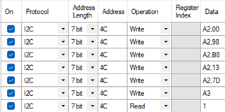

  • Hi Ishtiaque,
    The main problem is that the PMIC is connected over I2C, but all replied data equals 0x0.
    When following the guide to update the NVM by referring to Scalable PMIC NVM update guide, the first step to unlock the NVM is given by writing 0x98 to register 0xA2. If you look at the I2C communication captured on the scope, then I am able to write the value to the register (left side). However, I cannot read the value back as seen in the right side:
    Am I missing a first step before unlocking the NVM? This approach worked on the evaluation module, therefore I assumed it would work with the IC itself as well.

  • Hi Gertjan,
    Please follow instructions literally. That unlocking needs 4x writes to register 0xA2 and cannot be read during or after 4 writes.
    Br, Jari
  • Hi Jari,
    I did follow the instructions as specified in the scalable PMIC NVM Update Guide in Appendix D.
    However, when reading register 0xA3 after unlocking the NVM, bit 6 is not set and the returned byte is 0x00. If I follow the same procedure using the EVM, bit 6 is set and the returned byte is 0xC0.

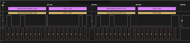

  • Hi Ishtiaque,
    Thank you for your answer and sorry for my late reply, I was caught up in some other projects.
    I have been looking into this problem again, and I still have the same error: I cannot read from any register on the PMIC. However, the PMIC is able to send an ACK on the SDA line, after which the SDA line goes to 3.3V again without any problems.
    Below you can find the scope image when probing the EVM (address 0x48) for the data at register 0x01:
    However, if I repeat the same procedure to ask the PMIC (address 0x4c) with the dedicated PCB for the data at register 0x01, we get a 0x00 reply:
    Since we do get an ACK from the PMIC, the PMIC can pull the SDA-line low. In addition, the pull-up resistors seem small enough such that the exponential rise time is small enough as well. Do you have an idea how this problem can be explained and fixed?

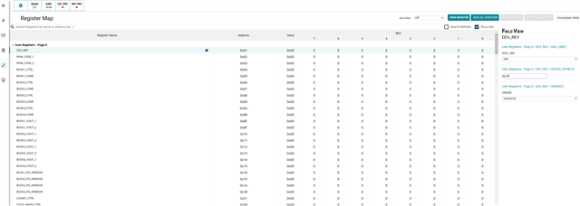

  • Hi Gertjan,
    1. What VCCA/input voltage have you set in the NVM and using in the system. If you set 5V input in the NVM and providing 3.3V. Can you try to increase first to 4V then try to read and still if the device reads 0x00 then increase to 5V and try reading again.
    2. or have you set in NVM 3.3V and you are providing 5 V?
    Because when I did change the VCCA to 5V with VCCA monitoring enabled and applied 3.3V then it read the same 0x00 as you have.
    See the register map below. It all reads zero. So I suspect that you either have any one condition mentioned above. Please try to look in that direction.
    BR,
    Ishtiaque

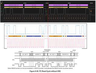

  • Hi Gertjan,
    Alright, not sure why so.
    Have you tried checking by replacing another device. May be the one which you are testing is broken or its EEPROM got corrupted ?
    Does the device power up at first time in your PCB?
    Can you share the NVM json file that you are trying to update? or you have updated to the LP876411B4RQKRQ1 device on your custom PCB?
    Also have you checked that your I2C host is working correctly with custom PCB? because I see some discrepancies in shared figure of I2C communication.
    You may look at the repeated start communication of I2C. Is it according to what datasheet suggests. I noticed (highlighted by vertical red line in below figure)  that after repeated start when SDA rise happens at the very edge of SCL fall as compared to normal communication where SDA transition should happen when SCL is low. This may may not be the exact cause because if you are using the same I2C host on EVM and it is working then this should also work but because it is custom PCB may be the hardware connections are differently routed and catching some noise and that might be creating the discrepancies that I just mentioned.
    BR,
    Ishtiaque

    Also have checked that your I2C host is working correctly with custom PCB? because I see some discrepancies in shared figure of I2C communication.
    I have looked into this again and changed some parameters. You can find the scope plot of the communication below which should have a valid repeated start if I am correct. In addition, I double checked again the I2C communication with a temperature sensor on the PCB and that one behaves normally. Therefore, I think the I2C host is not causing any problems.
    Is there something else that I might miss and that I could check to fix this problem or point towards where the problem is located?
    Kind regards,
    Gertjan
