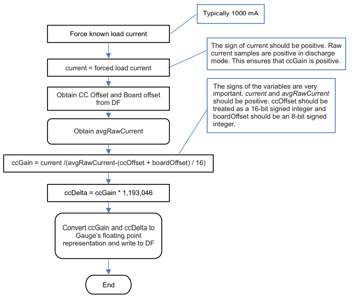

The Formula for Voltage calib is not good for the bq34z100.
The correct formula is newVoltageDivider = oldVoltageDivider*(forcedVoltage/rawVoltage)
Can you check if the formula for the Current Calib is OK for bq34z100? ccGain = calibCurrent/(avgRawCurrent-(ccOffset+boardOffset)16).
I don't find the correct value with this formula
