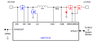

We want to use the MOSFET failure protection feature in this LM5170-Q1 by leaving the SYNCOUT open. However, nFault was remained shutdown (Low state) even there is no short circuit between high-sed and low-side of MOSFETs. My buck converter 48V to 12V is working fine if the MOSFET failure protection is disabled (SYNCOUT pin connected to a 10K to GRND). Please let me know what I'm missing here. Thank you.
  • Hi Chung,
    May I know if you used the circuit breaker (a pair of back-to-back MOSFETs) as shown below?
    The failure detection function must be deactivated if the circuit breaker is not present, or if the circuit breaker FETs are not controlled by the LM5170-Q1.
    Feng
  • Hi Feng Ji,
    Thank you for your reply. My original design does not have the circuit breaker (a pair of back-to-back MOSFETs) at the 12V output. To protect the over voltage to the load when MOSFET failed, I need to add the circuit breaker and enable the MOSFET failure protection this time by leaving the SYNCOUT pin open as shown in your diagram. However, due to this failure detection function enabled, the LM5170-Q1 is remained in shutdown mode even MOSFETs are not shorted! nFAULT pin is never pulled up HI, when EN1 & EN2 are HI, UVLO > 2.5V, and VCC> 8V! Please note that the LM5170-Q1 is working fine when failure detection mode is disabled (SYNCOUT pin with a 10KR connectred to GND).
    According to one of your TI Guru, Youhao, it looks like the mechanism to detect MOSFET failure is to sink or source 20mA to CSBx pin and detect the failure by monitoring SWx voltage pin. If this is correct, I'm afreaid that this SWx pin may not be able to raise to 4V-6V or lower to 1V to determine the MOSFET short due to a large output capacitance connected to CSBx in my circuit as shown in the attached diagram. In this mode, the nFAULT is only pulled up HI when 1.5V < UVLO < 2.5V! Please let me know how to make this MOSFET failure detection work. Am I missing something?

  • Hi Chung,
    You should connect the output capacitor to LV-Port but not CSB.
