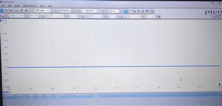

We tried to capture data on scope to see if cell balance was happening, ut we see a flat line and not balancing taking place. Also we tried to remove Q11 to make it host balancing with internal FETs but still no success.

  • Hi, Ajay here.
    As you have suggested, " You could try enabling balancing for Cell one and put the scope on VC0 with respect to Vss to see what is going on, or VC1 to Vss."
    We have tried this.
    When we turn on cell1 ,graph is look likes across vco to vss.
    AFE IS WORKING , MOSFET IS NOT TURNING ON IS OUR OBSERVATION. WHAT NEXT WE SHOULD DO.

  • This waveform is for vc1 to vss and same for vc0.
    I have already check for protection scenario, no protection is active.
    Software reads afe is working, afe also looks fine, but mosfet is not turning on, please help what may be the reason for not having cell balancing.

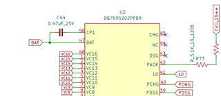

  • Also we are noticing that when the BMS is turned off there approx 500mV of drop across R23. Also when the device is on there is 60mV of drop across same resistor.
    What could be the reason for this?
  • Hello Vikram, Ajay,
    It does not make much sense to me that there is 0.5-V drops across R23 when the device is OFF, specially since it is much lower when ON.
    That would indicate there is 5-mA of current flowing somewhere.
    I have provided the schematic reference for this above.

  • If I power up the board for the first time (Using resistor ladder, turning ON 48V first time), the current drawn from R23 is just 24mV.
    Then if I wake up the device using Ignition and then turn off, (not the 48V supply, just the ignition) the drop across R23 is 400mV. Looks like some resistor settings that could be causing this, can you guide me to look at appropriate register settings in sleep mode to check if they are enabled incorrectly?

    I am a bit confused by "the device is OFF", is the part in SHUTDOWN or in another power mode? Still, 0.5-V across the R23 resistor would indicate that there is 5-mA flowing through it, which is very strange.
    Could you send me your schematic to review it, just to make sure all is okay? You can send this on private messages if you do not want to post it publicly.
