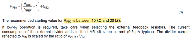

LM5148: Can RFB2 be chosen to lower than 10Kohm? for example, RFB2=4Kohm,any possible risks?
Part Number: LM5148
hi,
