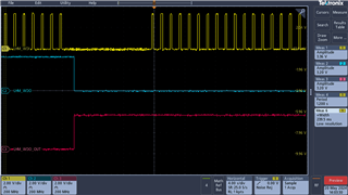

our client have a question is Why WDO pin always is High status?

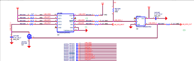

schematic:
Power on default waveform:
command output off:
command output on waveform: why WDO status is keep High?  is should be to Low status.

    In the first waveform screenshot the WDO(LHM_WDO) is in HIGH status, in the second waveform the WDO(LHM_WDO) is in LOW status , and in the third waveform WDO(LHM_WDO) is in LOW status. I do not see your issue of WDO pin always stuck HIGH. Could you please clarify your issue?

  • Hi, Joshua
    sorry to clarify, we talk about is LHM_WDO_OUT status.
    If Power on default waveform:
    LHM_WDI have a pulse
    LHM_WDO is High status
    LHM_WDO_OUT is Low status
    command output off waveform:
    LHM_WDO is Low status
    LHM_WDO_OUT is High status
    LHM_WDO is Low stasus
    our client concern is Chart1 and Chart 3, They have a pulse waveform(LHM_WDI), but chart 3 (LHM_WDO) should change to High status and (LHM_WDO_OUT) should change to Low status. why is different with chart 1?
    if any suggestion, Please advise me.
    Lawrence

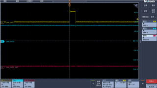

  • Hi Lawrence,
    The TPS3430-Q1 device is a window watchdog which requires the watchdog input(WDI) pulse to be provided within the window boundary. For your circuit SET0 and SET1 are both pulled high therefore your window is typically between 800ms and 1600ms. Accounting for watchdog error your window in worst case would be 920ms to 1360ms. Is the LHM_WDI pulse provided in chart 3 within this valid window? I also see that your LHM_WDI pulse occurs while WDO is low, the input at WDI is ignored when WDO is low. Could you have the customer increase the time scale and take a scope shot that captures multiple reset cycles, similar to Figure 8-5 in the datasheet.

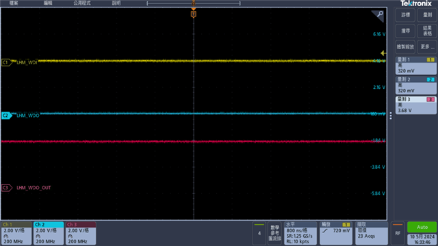

  • Hi Joshua
    Attached are my test images.
    When WDI starts sending pulses, WDO does not go high.
  • Hi Amy,
    Thank you for providing the scope capture, can you disconnect the trace from LHM_WDO_2 to the gate of FET UIC1010 or remove the FET entirely. When this FET is enabled you are shorting CRST to ground and essentially latching the LHM_WDO low.

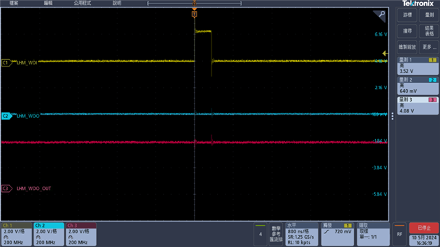

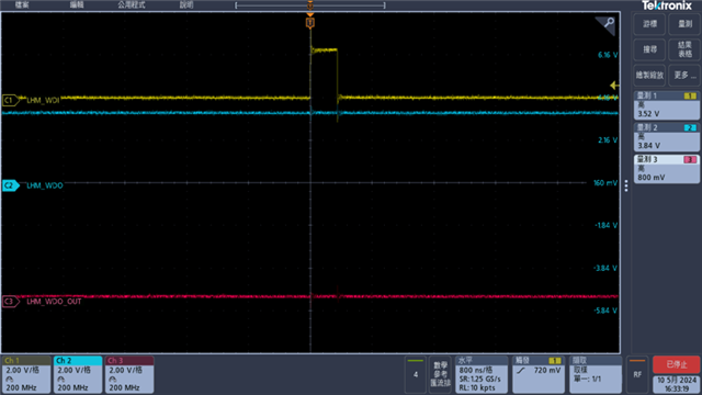

  • Hi Joshua
    I have removed the oscilloscope screenshot of UIC1010.
    1. The trigger mode is now functioning correctly.
    2. However, WDO has become a PWM output. How can this be resolved?
    Thanke
  • Hi Amy,
    When in fault condition, expected device behavior is WDO PWM.
    Joshua
