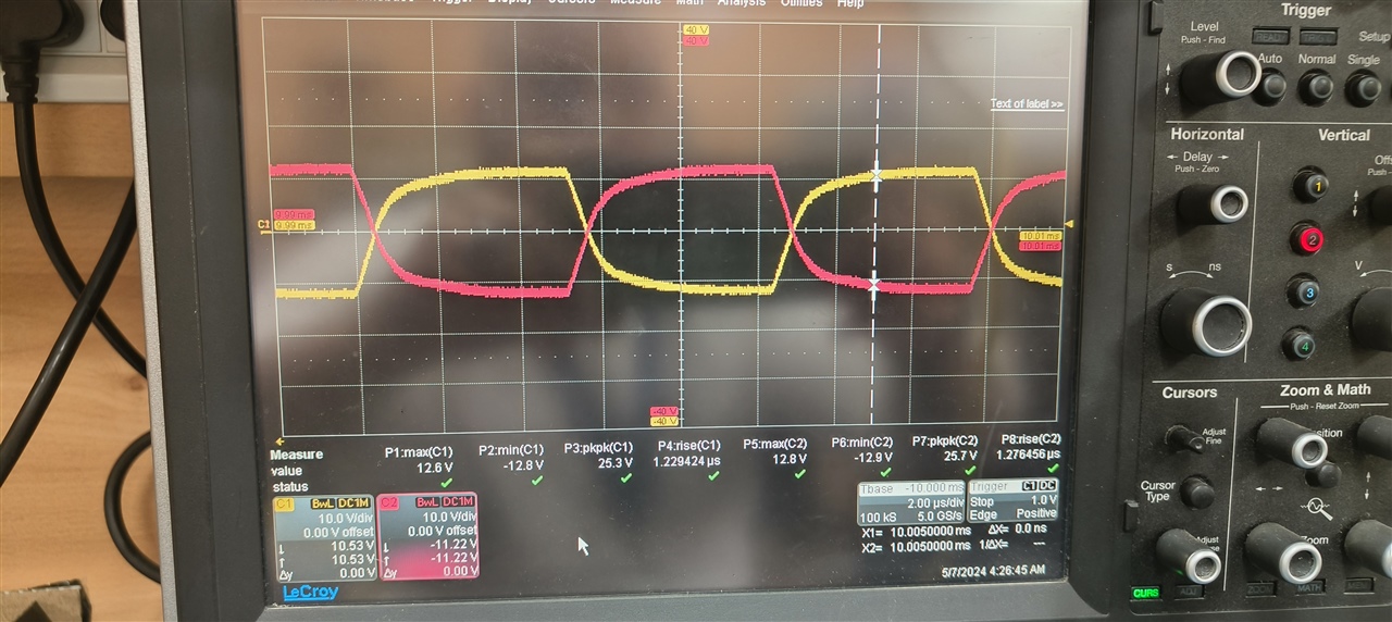

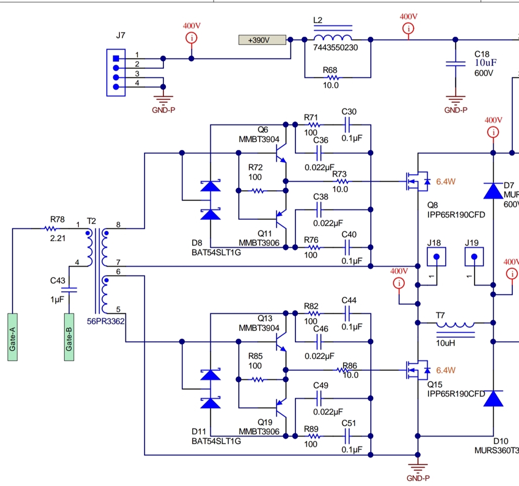

The driver is connected between ucc28951 controller and gate drive transformer to drive half bridge. I'm unable to check gate  waveforms as the driver is heating up.
I tried Vdd :15V, 12V.
Below is the circuit design.
Below are part numbers:

    It may be that the input signals are exceeding the ratings set by the datasheet. Can you send the waveforms for the input signals of the driver? If you made your own schematic, can you send that as well, alongside the layout?
    Rubas
  • Salam khalid.
    Below is the circuit. Layout is followed as per the suggested layout in the datasheet, I will share layout by tomo.
    Above waveform is taken Vdd : 15V. After a period of few seconds , driver starts to heat.

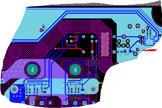

    Layout: 2 drivers
    Dark Blue: Signals coming from controller
    Sky blue: ground
    Purple layer Vias: Power supply

    Typically, gate drivers can heat up due to inputting a very high frequency or signal amplitude.
    It looks like your output waveforms (assuming they were taken at your Gate-A and Gate-B test points), have a long rise/fall time, indicating a heavy load. Can you send current waveforms of the primary side?
    We also have an app note related to using gate driver transformers, which may be helpful: www.ti.com/.../slla602.pdf
