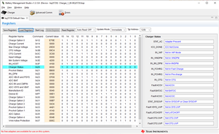

We are facing the output in the battery charger. We are working on the laptop project based on intel alder lake 15W design in which we are using battery charger BQ25720RSNR.
Our board is rebooting when try to boot to the OS level. We have captured the output voltage of battery charger (VCC_VBATA), we found that there is dip in the output voltage till 6V due to which my complete system got rebooted.
We have capture the waveform of the VCC_VBATA.
Below is the screenshot:
We have also capture the input voltage whether that is also dropping while VCC_VBATA drops, but there is no drop on the input voltage i.e VCC_BCHGR_IN
We have attached the waveform and schematic for your reference. Kindly check and help to resolve the issue.

  • HI Udesh,
    Could you provide the register dump (all the register settings) after the event? Register 0x20 is charger status, which can tell us what happened in the charger. See below default settings.
    Tiger
  • HI Tiger
    We have captured the resistor dump when we are facing issue.
    0x12: 0xe70e
    0x14: 0x0700
    0x15: 0x3138
    0x20: 0x8000
    0x21: 0xb800
    0x22: 0x5000
    0x23: 0xc800
    0x24: 0x0000
    0x25: 0x0000
    0x26: 0x0000
    0x30: 0x3300
    0x31: 0x00b7
    0x32: 0x0434
    0x33: 0x4a81
    0x34: 0x41a0
    0x35: 0x2000
    0x36: 0x0048
    0x37: 0x006c
    0x3b: 0x09c4
    0x3c: 0x3c00
    0x3d: 0x3980
    0x3e: 0x5c00
    0x3f: 0x5000
    0xfe: 0x0040
    0xff: 0x00e1
    Also please let us know how we can set the battery charger output current. Is there any resistor which will configure the battery charger output ?
    we are suspecting that might be, battery charger configuration is not proper due to that it is not able to provide the sufficient output power.
  • Hi Udesh,
    The register map looks fine. There is no resistor to program the charge current. It is a digital part, you can use charge current register to set the charge current.
    I would suggest you monitoring the system current. You may be overload the charger.
    Tiger
