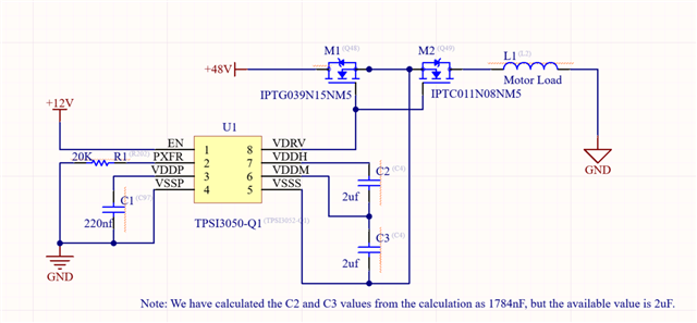

  • Hello Tilden,
    Thank you for your reply,
    We are planning to use TPSI305x-Q1 (Driver) and IPTC011N08NM5 (MOSFET) for our design and Also,we are going with two wire mode design and below attached schematic snap.kindly check this selected value on this schematic.
    MOSFET Qg = 446nC
    1.what is the minimum & maximum VDRV pin (Iout current)? how can we calculate the Iout current for our design?
    2.Panasonic recommended GATE resistor for their driver circuit, as shown in the attached snippet. We are planning to use TPSI305x-Q1 (Driver) and IPTC011N08NM5 (MOSFET) for our design. Could you please confirm whether that gate resistor is needed for our design? If it is needed, then how can we calculate the gate resistor for our design?.
