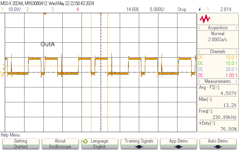

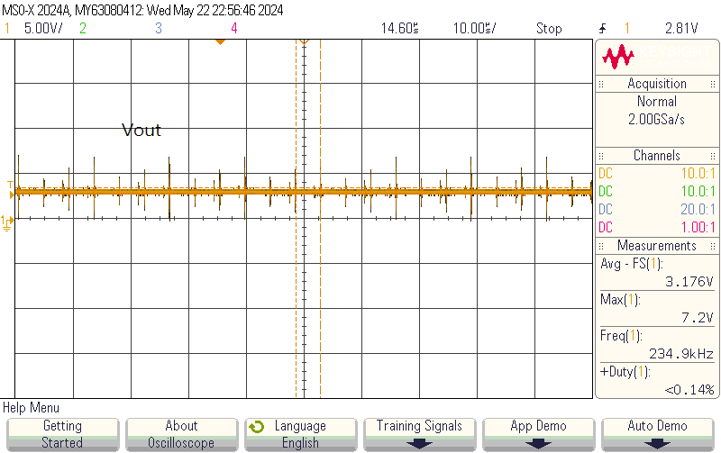

The input voltage for the LM5025AEVAL is 36V to 72V, but why is it that the one I built can only output normally from 36V to 39V.
Also, when it outputs normally, the waveform of OutA is abnormal. I have already increased the filter resistor and capacitor values for CS1, but it seems to have made no improvement.

    However, I have not modified the EVM circuit; it was built entirely according to the provided specifications.

    I have a problem now, after I increase the volt second clamp, the output voltage drops to 1.5V and seems unstable.
    Check and make loop compensation and test the bode plots to make enough phase margin.
