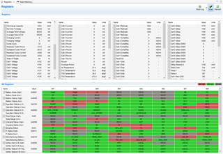

    Hi Anthony, please find the gg file attached. What I have observed is that the REST bit is set, the cell balancing only starts when I connect the battery with the gauge but after some time, the BAL_EN bit clears and the balancing stops. Please see the picture attached which shows the maximum delta being around 30mV and the gauge being at REST. Despite these conditions, the BAL_EN bit is clear.

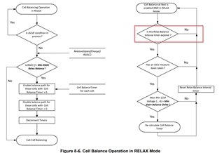

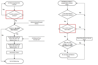

    The dV/dt condition is measured over a 1 second interval to ensure that the cell is truly at rest. I believe below are the two conditions where the dV/dt condition can affect the process seen below:
    For the OCV measurement to be taken, the dV/dt condition will need to be passed, which is why that point could be causing an issue as well.

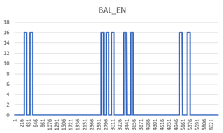

    While looking through the Relax mode log 2, the BAL_EN follows this pattern, where each spike is exactly 300s long, matching the Relax Balance interval which is the timer each check is made. If possible, can extending this interval be tested to see if the results improve? It seems like in some situations the conditions are being met in others it is not.
    Anthony Baldino

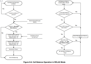

    I set the timer to 300s instead of the default value of 18000s (6 hours) as I was unclear what happens in a situation when the cells are still unbalanced, but the individual cell balancing timers reach 0, before the 6 hours are over? In that case, will the gauge wait till the 6 hours are complete before recalculating the individual cell balancing timers.
    I believe that increasing this value could potentially assist the issue being seen. You are correct, if the value is set to 6 hours, then it will not check to recalculate the cell balance timers until then even if the cells are still unbalanced since this is the first condition to recalculate:
    If the worry is that the cell balancing will not be recalculated enough with 6 hours, then I believe 1 hour should be tested first for this value and we can go from there.

  • Hi, Anthony,
    I increased the Timer to 3600 seconds, but the the pattern followed is still the same, but the duration increased to an hour. Please find the log and the GG file attached.6s1p_LS14_TI.gg.csv

    Thank you for sending those files.
    After looking through the firmware at the behavior of the BAL_EN bit, I believe that when the Balance Interval expires, this bit will not be set again while there are OCV measurements being completed. I find this interesting since it may be why the default value for the Balance interval is 5 hours, because once it exits, the OCV measurement condition might hold it up BAL_EN becoming set again. When set to 5 hours, once the gauge has processed its initial measurements in relax, then the gauge can balance for the rest of the relax time. Would it be possible to try the 18000s value for the Balance interval?
