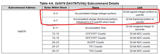

    Is there any such guide or document to work with accumulated charge registers in data stratus 6? I am seeing that if I read this register continuously, it resets to 0 after random period between 10 to 20 Seconds. also, the values are also irrelevant and continuously fluctuating rather than accumulating. means I can get one value positive and the next value negative.

    I was trying to read following register.
    This is byte 0-3 and  4-7 of the 0x0076 DATASTATUS6() subcommand.
    I will take a log and provide the same. do you suggest not to use this register for SOC calculation? We had planned to rely on this register for SOC calculation so that MCU can be in sleep while in idle mode. otherwise MCU has to continuously keep a track of current.
  • Hello Swapnil,
    For accumulated charge, this is the register you would want to use and we do recommend to use it for this type of application.
    Do let me know of the logs! I'd definitely like to know what is going on there, so a log may shed some light on what is going on. Additionally, the test conditions for when you are testing this would also be great to know!

    Accumulated charge and accumulated charge time also set to 0.
    Correct, a partial RESET will cause these to be reset and will need to be re-initialized. See Section 3.9 Why is the accumulated charge measurement seems to be producing an incorrect value? of the BQ769x2 Frequently Asked Questions document.
