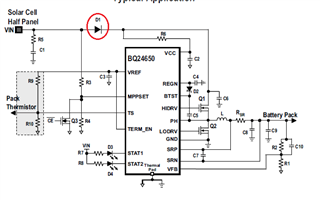

What are the alternatives to the diode indicated in the SLVA829 document?
The use of a diode with high load currents has too high a thermal dissipation.
What solutions are there to protect the BQ24650 from a solar panel connected with reversed polarity, other than the obvious one of using a diode?
thanks.
regards
Jose

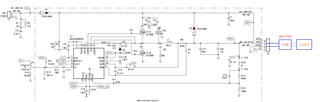

    In the meantime, we have developed a circuit, which we have tested in the laboratory using a solar panel simulator and a battery simulator.
    After detailed testing, data collection and analysis, we concluded that the circuit's performance is exceptional.
    However, when we placed the PCB in an outdoor test system with a solar panel and battery, the charge never started!
    We went back to the lab and used the same real battery that we were using in the outdoor test system, and a solar panel simulator, and different types of power supply as an alternative to the solar panel simulator - it works perfectly.
    We can't understand what's going on ... and why it works exceptionally well in the laboratory and doesn't work with a solar panel.
    Could I send you the circuit in a private message, so that you can give your opinion of what's going on, and why the bq24650 never starts charging.

    Thank you for your reply, and I've already sent you an e-mail with the schematic drawing and a description of the problem.

  • Hello Jose,
    I'm reviewing your schematic, and will provide an update by EOD Tuesday.
    Christian.

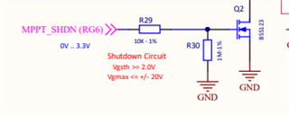

  • Hello Jose,
    What is MPPT_SHDN? Is this pulled up by the VREF pin?
    Christian.
  • Hello Christian,
    The MPPT_SHDN (RG6) label is connected directly to a microcontroller output. We use this signal to shut down the BQ24650 in versions where the MPPT charger is disabled.
    In the previous version we used this signal to shut down the BQ24650 when the solar panel voltage was between Vmp and Vbat, thus preventing the BQ24650 from consuming battery reverse current.
    regards
    Jose
  • Hello Jose,
    I have a few suggestions to try:
    Can you re-run the test with R29 tied to Vref?
    What are you using as the battery? have you tried using a different battery or battery simulator
    The next step is replacing the IC. Your team measure Vmppset = 1.510V when the board is not charging, the device should regulate this voltage to 1.2V. This could indicate the IC is damaged.
    Christian.
  • Hello Christian,
    What is the purpose of your suggestion to connect R29 to Vref?
    If we connect R29 to Vref, which is 3.3V, the Mosfet will be ON, the MPPSET pin connected to GND and the BQ24650 will be in shutdown. What can we conclude?

    The reason we use the diode is exactly to prevent reverse current from the battery, as described in the TI document - Prevent BQ24650 leakage current (SLVA829).
    Your schematic shows two ideal diodes, one at the input and one at the output. These two diodes are serving the same purpose of blocking reverse current. In the app note It shows to remove the input diode if you are going to be using one at the output. So I recommend removing this diode.
    Do you have any idea what might be happening, and why the diode is giving problems?
    We have not ran into this problem before, so I can't give an exact reason on why this is giving a problem. I think the issue is using both diode, one at the input and one at the output. Another test to try is to shunt the input diode and keep the output diode and see if are still seeing the same issue.
    Christian.
  • Hello Christian,
    The diode next to the solar panel is intended to protect the circuit from the solar panel being connected with reversed polarity, and it works well.
    If this diode next to the sola rpanel is removed, and only the diode next to the battery is kept, the circuit will not work properly.
    This is actually the concept of the SLVA829 document, but it doesn't work with the ideal diode.
    Our tests clearly show that the problem is only solved when we remove the diode next to the battery, and therefore lose the functionality of preventing reverse current from the battery through the BQ24650. In fact, that was the only purpose for which we used this diode.

  • Hello Jose,
    I'm discussing this issue with another team member, to see if we have a work around.
    In the app note you mentioned, the diode off of SRN  is used to prevent leakage current. The app note mentioned in order to use this method, diode1 has to be removed. That is why I suggested removing the input diode.
    The diode is also required to be placed between the SRN pin and the resistor feedback network, but on your schematic the diode does not seem to be connected to the resistor feedback network.
    Christian.

    The only way to get the charge started is to make a quick shunt between MPPTSET and Gnd.
    We initially thought that the problem was in the battery's BMS, so we used fully discharged supercapacitors as an alternative to the battery.
    The result was the same.

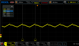

    We checked with the oscilloscope what signal we have at VOUT, and found that the voltage oscillates between 4.166V and 5.766V
    Our problem is that if the charge is not started we have no power to start the microcontroller, and therefore we have no way of making the shunt in MPPTSET that would solve the problem.
    Using the EVM board concept (using VSYS) isn't feasible for us, as all the electronics don't support more than 18Vdc.
    Designing an independent circuit to manage this problem, and making the necessary shunt to the MPPSET to start the charge, will increase the cost of manufacturing the circuit, as well as the area of the circuit, which we don't have the space for.
    We have no doubt that the charge is not initiated by the BQ24650 under the conditions described above, so we are looking for suggestions on how to solve the problem described.
