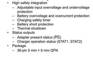

BQ25756: What are the features list The BQ52756 charger controller support?
Part Number: BQ25756
Other Parts Discussed in Thread: BQ25750
---> above snippet from BQ25756 charger controller data sheet and here the mention some functionality or feature of the charger controller so i list some features and created functions with description for external STM microcontroller.
FUNCTIONS for BQ25756 Features                                                                      | DESCRIPTIONS                                                                                                     |
HAL_StatusTypeDef BQ25756_SetOverVoltageLimit(uint8_t value);                   | Sets the over-voltage limit on the BQ25756 charger controller.
HAL_StatusTypeDef BQ25756_SetUnderVoltageLimit(uint8_t value);                 | Sets the under-voltage limit on the BQ25756 charger controller.
HAL_StatusTypeDef BQ25756_SetUnderCurrentLimit(uint8_t value);                 | Sets the under-current limit on the BQ25756 charger controller.
HAL_StatusTypeDef BQ25756_SetChargingSafetyTimer(uint8_t value);            | Sets the charging safety timer on the BQ25756 charger controller.
HAL_StatusTypeDef BQ25756_ReadAdapterStatus(uint8_t *status);                 | Reads the adapter present status from the BQ25756 charger controller.
HAL_StatusTypeDef BQ25756_ReadChargerOperationStatus(uint8_t *status); | Reads the charger operation status from the BQ25756 charger controller.
HAL_StatusTypeDef BQ25756_SetAutonomousChargingMode(uint8_t value);  | Sets the autonomous charging mode on the BQ25756 charger controller.
-----> Now i need to know what are the features and functionalities list that BQ25756 can Support
  • Hello Sankar,
    For the BQ25756, ACOV and ACUV are set by resistors in hardware. VAC_DPM can be set by registers.
    Can you elaborate on what you mean by "features and functionalities list that BQ25756 can Support"?

    ----> so i need what are the features it can support ?
  • Hello Sankar,
    Did the FreeRTOS driver help?
    You already listed a lot of the driver functions. For the functions you'll need, there is also the:
    MPPT function
    Reverse mode
    Charger Flags and Statuses
    A few notes about the functions you listed. The BQ25756 is a non-power path charger and doesn't have any power path features. If you need a power path, the BQ25750 is just like the bQ25750, but it has a direct power path to power a system load and a battery.
    What all functions do you need? Can you tell me your application so I can help you out a bit more? Information like battery voltage, battery chemistry, battery current, and input voltage would help a lot.
