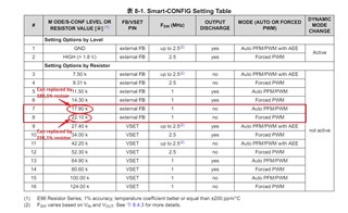

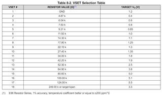

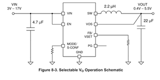

We have one question about the resistor selection for the mode selection and device configuration (MODE/S-CONF Pin). From the Smart-CONFIG Setting Table (table 8) we can set the voltage regulation method, frequency conversion, and operating mode by choose the resistor value of the MODE/S-CONF Pin. But some resistance values are not common, can we replace them with commonly used resistors with similar values?
For example, using 18K,1% resistance instead of 17.80K, and using22K,1% resistance instead of 22.10K.
