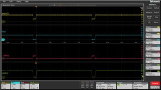

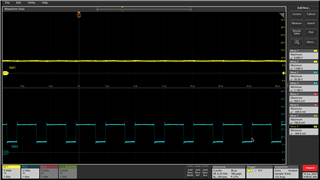

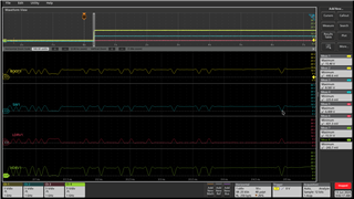

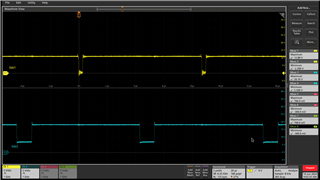

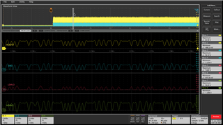

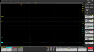

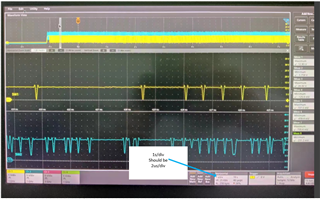

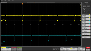

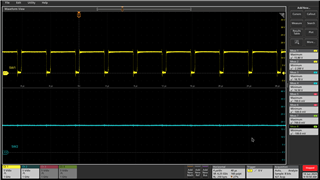

Based on LM5176EVM-HP schematic to design LM5176 6-38 V buck-boost 12V, the range of input source is from 6V to 38V, I want to use LM5176 to buck-boost and keep the stable output at 12V.
https://e2e.ti.com/support/power-management-group/power-management/f/power-management-forum/1281095/lm5176-lm5176-schematic-review-check-buck-boost-functional?tisearch=e2e-sitesearch&keymatch=LM5176#
Buck mode is normal. but can not work in Boost mode
Vin=14V, Vout=12.08V (Buck Mode OK)
Vin=13V, Vout=11.62V (Start to drop voltage)
Vin=12V, Vout=11.38V (Drop voltage)
Vin=10V, Vout=9.97V (Can not normally work in boost mode)
Vin=9V, Vout=8.97V (Can not normally work in boost mode)
Vin=8V, Vout=7.97V (Can not normally work in boost mode)
Would you please like to check this boost functional issue?
