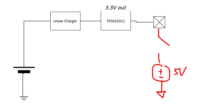

Reverse current mode in FPWM mode is supported by the device.
In this mode of op, Q1 / Q4 are on with 100% duty cycle? or
For a certain application, normally PFM mode is preferred because light load efficiency is preferred.
However allowing reverse current into the device with a built in current limit could theoretically be used for lithium ion charging with safety.
Is this reverse op use case possible and are there other considerations?
