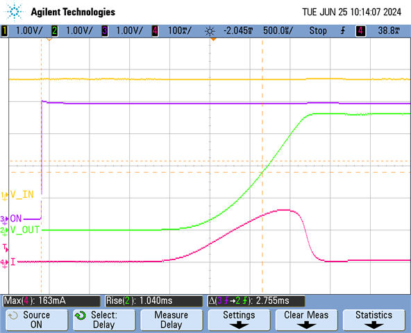

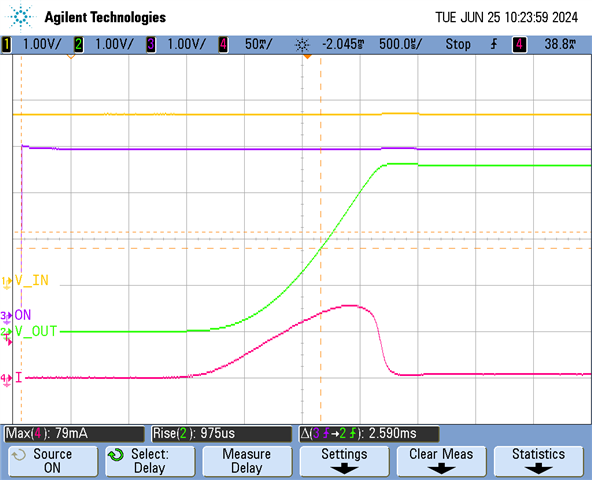

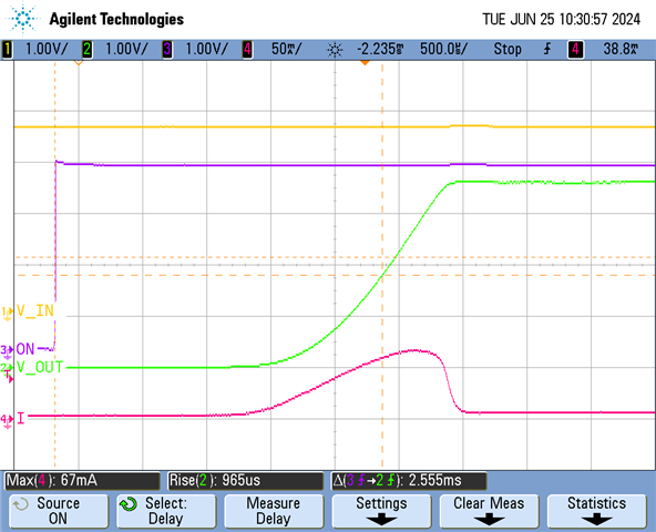

    Having said that, I have obtained an EVM of TPS22917 and performed some measurements with different CL, please see the following results:
    The operating conditions of each test apart from CL are identical:
    CT=1000pF (Based on the TPS22917 EVM user guide ) Vin= 3.6V and RL= 1K
    CL=47uF
    CL=22uF
    CL=15uF
    You can find the summer here:
    Measurement results
    Calculated
    CL (uF) CT (pF) I_inrush (mA) TR (us) I_inrush (mA) TR (us) Inrush current difference
    47 1000 163 1040 89.3 1600 182.53%
    22 1000 79 975 41.8 1600 189.00%
    15 1000 67 965 28.5 1600 235.09%
    As you can see above the measurement result for 47uF load is almost in concur with  the measurement result shown in graph 10-3 in the datasheet.
    I would appreciate it if you could let me know why the measured inrush current for each load is higher than the calculated one and the rise time is lower?
    Amir

  • Hi Amir,
    Looking at our EVM we noticed that the loading conditions could cause a large difference such as the one that you found. For example on our EVM the built in CT was 1340 pF. If possible could you unsolder and measure the capacitor on the CT pin to verify its capacitance?
    Another thing that accounted for the differences you are seeing is that RL = 10 ohms on the datasheet measurements for slew rate and rise time compared to the RL of 1k that you are using in your tests. Accounting for these 2 differences the rise time should be within 20% of the calculated values.
    If you need to determine values for a schematic account for an extra +-20% variance from the typical given in the data sheet and make sure to check everything with the EVM to verify the results. Make sure to also use risetime instead of slew rate when doing calculations as slew rate only accounts for the fastest portion of the ramping.
    Nicholas
