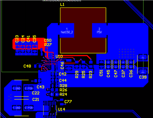

    How does the updated layout look then? I've shifted the output capacitors over to put the TRIP and EN resistors next to C46 (VCC) and added the AGND which direct connects to solid PGND on plane below.
    Also, do you see any issues with the input/output capacitance (before or current)?
    How would I determine on my own that a 220pF CFF is required?
  • Hi Zach,
    The input/output capacitors look okay.
    Is this the AGND plane? How does it connect to the AGND pin?

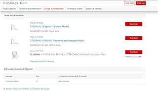

    We have a design calculator on the web that you can use to enter schematic values and it will provide feedback:
    Ryan

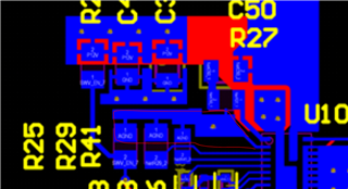

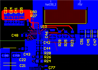

  • Hi Ryan,
    Thanks for your quick response here. It's been very useful and helped point me to the right area for tools you provide. I've attached the updated schematics, where I've swapped to 800kHz switching and included the new 220pF Cff (based on the design spreadsheet it should remain 220pF). I've also updated the layout images with close-ups of the different areas. AGRND connects to GND on the inner plane. I think we are all good now, but would love any additional review.
    Typically i would place components on the top/bottom layers, but we have another piece that mounts flush with the top so we can only route traces there, no components.

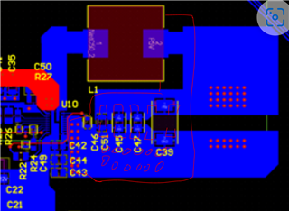

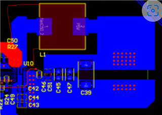

  • Hi Zach,
    The schematic looks okay. Regarding the schematic, I would recommend to connect AGND components with a larger pour like this:
    I would also recommend increasing the width of the traces SW.
    VOUT trace should be wide but also short with the output capacitors close to the output of inductor with the vias shortly after the output capacitors:

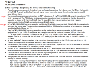

    Here are some other layout recommendations from the datasheet:
