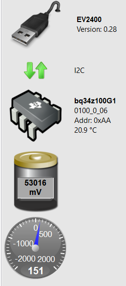

Hi I'm attempting to complete a learning cycle using the BQ34Z100 EVM and EV2400. The batteries using are Vision AGM EVL16-400A . We have 8 of these in series to make a 400Ah capacity 48V pack.
I've selected the trojan 105 chemistry code 0811 as what I thought would be the best match so far but I'm wondering if a new chemistry ID needs to be created as I've been unsuccessful with learning cycles so far. GPC Report states deviation is above recommended level and a new chem ID needs to be released for this cell.

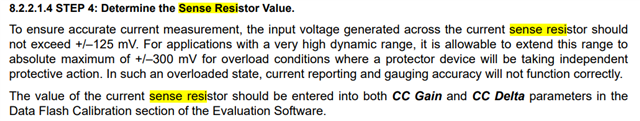

We are also having issues with current calibration, calibrated using the steps in SLUA760. But when there is no load or charging the average current shows around 180mA, with the scaling factor of 14 is about 2.5A.
This is causing issues with the learning cycle as it doesn't recognise the end of the charge cycle and FC bit never gets set.
