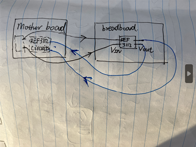

Hello Expert,
My customer met a oscillation issue of REF3112. Do you mind helping to have a view on it?
The details are shown in slides.

    3. In page 3, REF3112-Q1 is soldered on a breadboard without 10uF capacitor and the breadboard is connected to the motherboard. There is no other REF3112-Q1 in motherboard.
    In page 6, the difference between the circuit in page 3 is an 10uF capacitor added. For GOOD REF3112-Q1, the output wave still is good. For failured REF3112-Q1, the output wave becomes oscillated.

    The failure device is happening in 1 device after the customer did high temperature test for their boards.
    As the slides shown, if the customer add a 2Ohm before Cout, the Vout will become normal.
    In page 3, the customer only move REF3112 chip to a breadboard and leave other REF3112-Q1 surround circuits (including 10uF COUT) in motherboard. And use wires to connect mother board and breadboard together.
    Wenting
