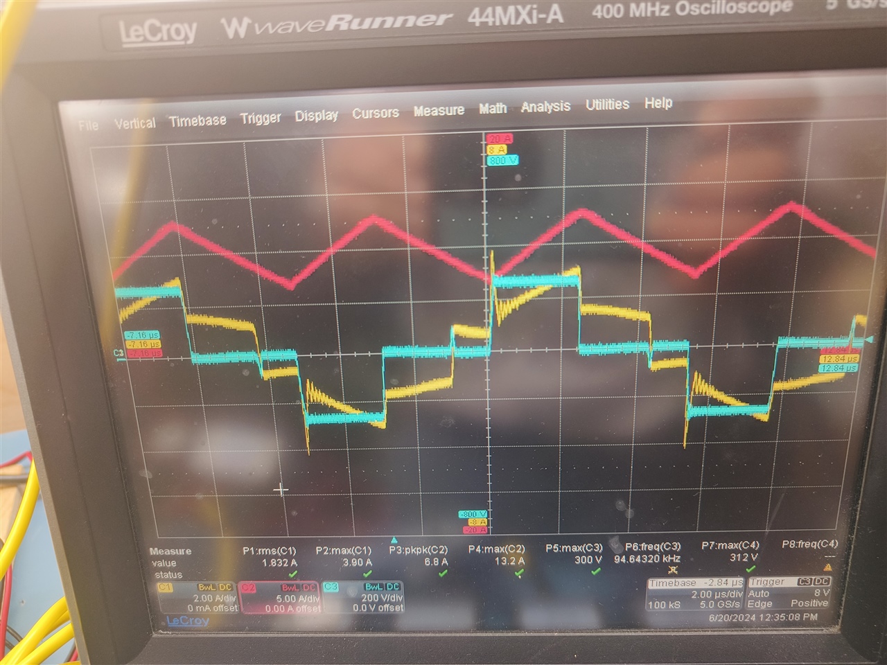

1. Below are the primary current waveforms,
Along with inductor current. Are they correct ? Why the initial peak in current?
Yellow: primary current
Red: inductor current
Blue: transformer primary

    1.  In regards to the waveforms in scope plot 1  they look as expected, except the large spike in current when the design comes out of freewheeling.
    This could be due to your SR timing being off.  You might want to double the SR timing to make sure it is not causing this leading edge current spike.

    3.  Your waveforms seem to have a constant duty cycle.  So these oscitations may not be do to loop instability.  They could be caused by trace inductance, transformer and output leakage inductance.  If this is the case you may be able to the fix the issue with one or all of the following.
    a.) R C snubber across the output rectifiers R = (L/C)^0.5.  I set C to (1/fsw)*(0.02/(3*R).
    b.) Some designer use R C snubber across the shim inductor as well.
    c.) If the snubber does not work your trace lengths in your power stage might be to long.  Consider relaying out the board to reduce trace inductance.
    d.) There might be too much leakage inductance in your inductor and transformer. You can reduce this by selecting magnetics with less leakage inductance.

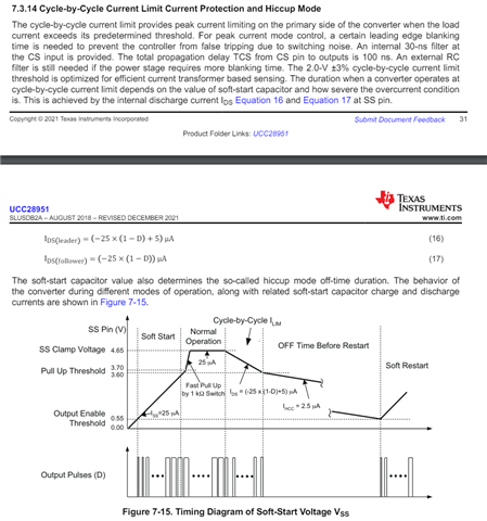

    Q4: there was a scenario, Vin : 300VDC, LOad current more than 10A, controller was shutting down. Was it hitting any limit ? FYI, at low voltage around vin:  200V , I have gone upto 15A. Any thoughts here ??
    >If you are hitting cycle by cycle current limit of 2 V to long the controller will shutdown and reactivate soft start.   This is known as over current hiccup mode protection is described below.
    >Your transformer current is showing excessive current and the cycle by cycle current limit is protecting your FETs.  You need to figure out what is causing this excessive current and correct it.  My guess is that your SRs are on when they should not be.  Please note the tool estimates the timing setting for ADELEF.  You need to verify and adjust based on actual circuit performance.

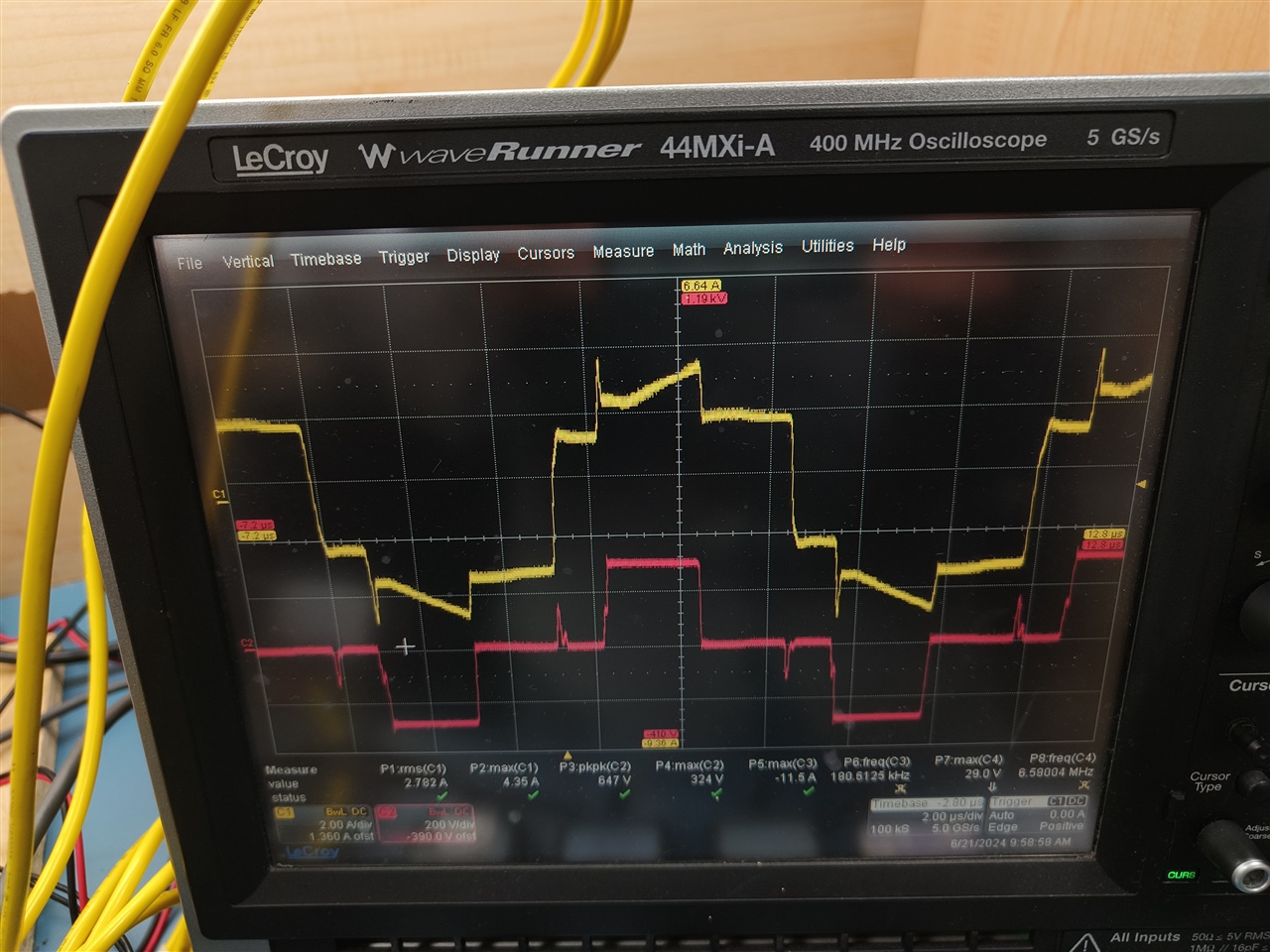

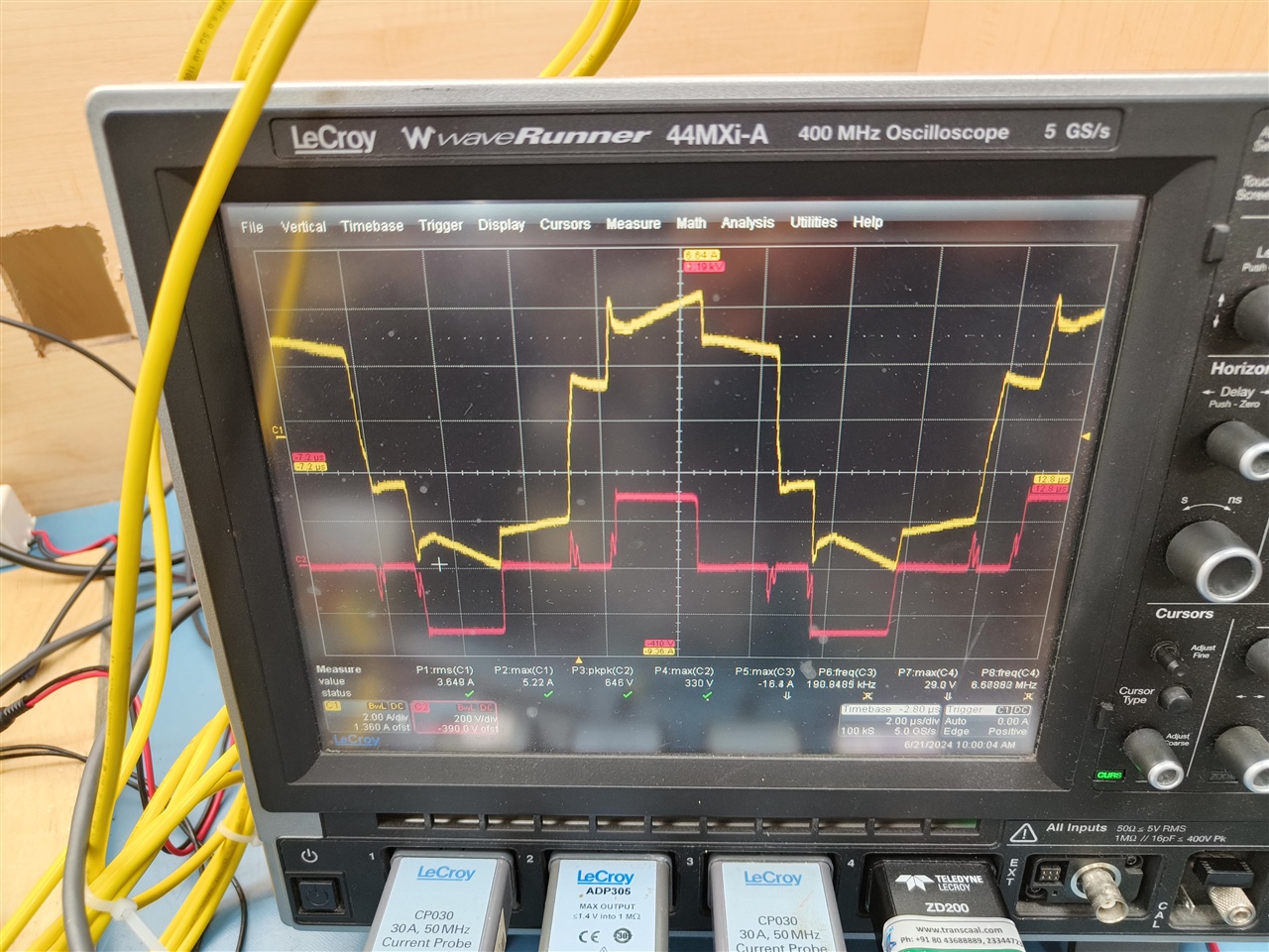

  • Below are today's test results.
    FYI, ADAPTIVE delays have been shorted to ground.
    Added resonant inductor 10uH, freewheeling diodes, I'm able to load upto 26Amps.
    Below waveforms for 5A, Vin : 270VDC
    Below waveforms for 15A, Vin : 270VDC
    Below waveforms for 20A, Vin : 270VDC
    Below waveforms for 25A, Vin : 270VDC
    Going beyond 26A, it's shutting down, maybe since it's hitting over current limit. Additionally I did increase DELEF from 24k to 47K as you said , but no change is observed.
    What I also noticed output side ringing stays same in amplitude with increasing current from 10A to 25A. My understanding is primary side current peak issue is  different and ringing at secondary is different. Still not worked on snubber circuit as I was focussing on primary current peak.
    Is there any significance change in primary side current ? What is happening? Please explain and how do I go forward ?

    It seems that the changes you made have reduced the ringing that was seen on the transformer primary current.
    It also looks like you are getting more current out of the design so it seems like you making progress.
    You increased the delay time on the E F FET turn on delay and it did not remove the CS spike on the transformer primary current.
    So this may not be the cause of the issue.  However, you might want to study the gates of the SR FETs with the primary current of the transformer just to make sure these FETs are not the cause.
    I do believe the leading edge current spike on the transformers primary current when coming out of freewheeling is preventing you from achieving full power in your design.  If you can remove this spike the design will behave better.
    You might want to check the gate of the FETs compared to the transformer primary current to see if the timing the FETs is correct.  If you turn on the H Bridge FETs on to early this could cause a current spike in the transformer primary current.  di =V*dt/L  You want to turn the FETs on at the bottom of the resonant ring at the switch nodes.  You can set the delay timings of the H Bridge FETs at 10% load.
