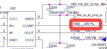

A my account wants to check if there is any risk for UCC5350M when CLAMP pin is floating(R1093 is unintentionally removed)? the schematic of UCC5350M is shown as below.

The gate driver will have no problem if CLAMP is floating. However, I recommend you still leave it connected to the gate as intended. Miller injection is a serious threat to the half bridge, and I recommend designing as much redundancy as possible to prevent this issue. Even if it has a long Vgs pull-down loop, a long Miller clamp is better than nothing.
Unless you are using GAN, which does not have Miller injection.
