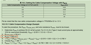

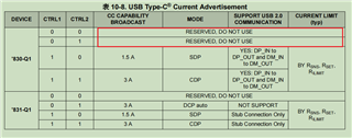

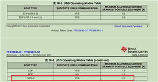

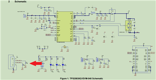

Hi Team,
This is FAE Jayden, ZTE is using TPS25830&TPS25840 in their auto project. Could you help support schematic review? Many Thanks.
ZTE applications are:
① TYPE-C interface, using TPS25830 for charging (5V/3.5A), USB BOOT, and data transmission.
② TYPE-A interface, using TPS25840 for charging (5V/3.5A) and data transmission.
③ TYPE-C interface, using TPS25830 for charging (5V/3.5A) and data transmission.
The output inductor L1 of TPS25830 and TPS25840 will be replaced with SRP5030TA-2R2M (2.2uH, 5.5A) in the future.
zxic_usb_tps25840_s0.pdfzxic_usb_tps25830_s0.pdf
Brs
Jayden
