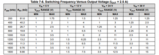

Dear Specialists,
My customer is considering TPSM33625FRDNR and has a question.
I would be grateful if you could advise
I have a question about the TPSM33625FRDNR.
This model operates at a fixed frequency of 1MHz, so as I understand it does not function as an RT pin and only works as a MODE/SYNC pin.
On the other hand, is it correct to assume that Table 7-6 on page 19 of the datasheet shows the output voltage for the input voltage of a device that functions as an RT pin?
In other words, is it correct to understand that a device that functions as a MODE/SYNC pin can output VIN=24V, FSW=1000kHz, and VOUT=12V?
It is also shown in a form that can be configured on Webench.
