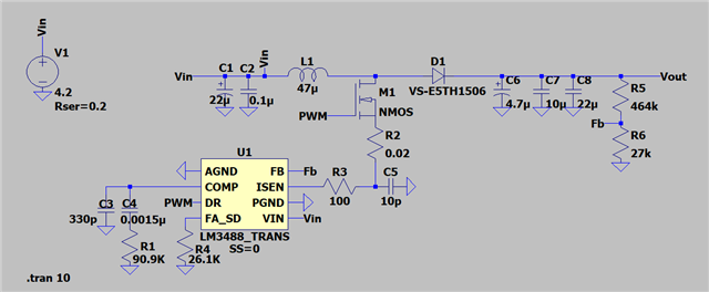

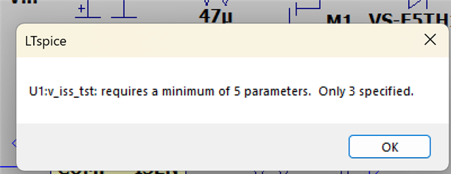

Hello, I have downloaded unencrypted model for PSpice from LM3488 page and uploaded it to LTspice for simulation. I assembled the circuit and when tried to play transient simulation, got this error: "U1:v_iss_tst: requires a minimum of 5 parameters. Only 3 specified".
I didn't changed anything inside this converter model, so is it faulty ? Can anyone share working spice model of this part? I will also add my circuit:
