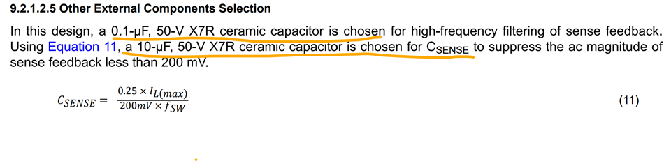

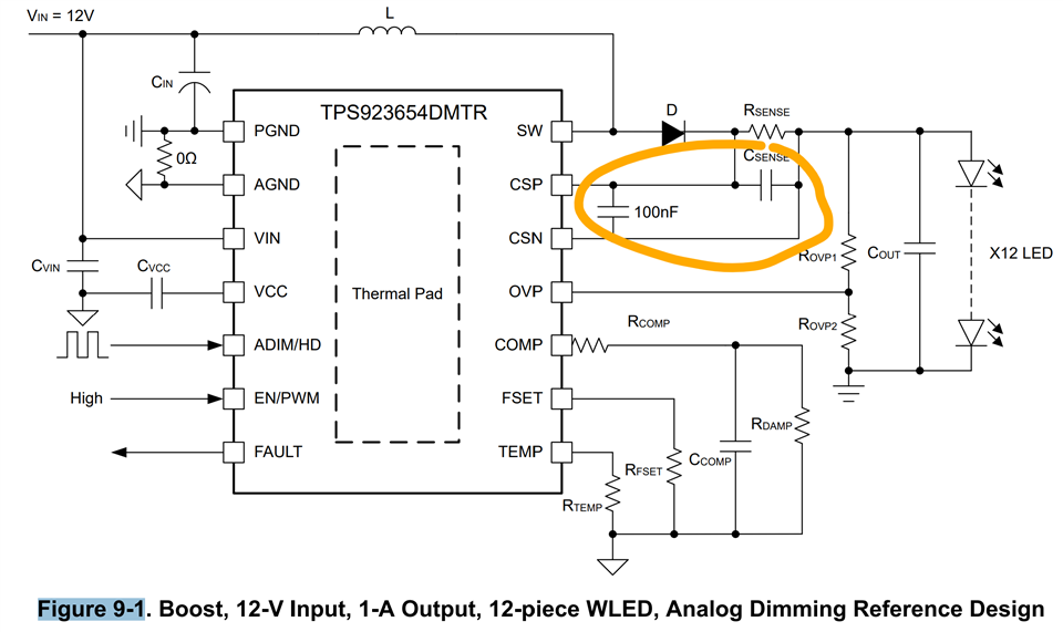

1. Figure 9-1 shows CSENSE capacitor in parallel with another 100nF capacitor. Is this diagram correct?
The reason why I ask it because it seems that section 9.2.1.2.5 "Other External Components Selection" may be describing two different capacitors, with two different functions while on the Figure 9-1 both capacitors are in parallel configuration. Why use two capacitors? Is it to reduce ESR? In any case it is a bit confusing. Are two capacitors really required? Please clarify.

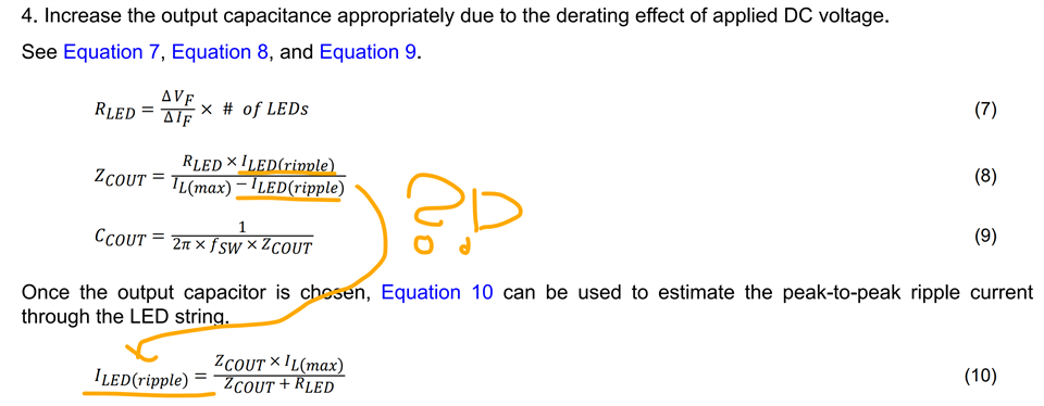

2. In the equation (8) ILED(ripple) is used but then in equation (10) it is calculated. Likely it is a mistake. Maybe in equation (8) ILED(max) should be used instead?
ILED(max) does not appear to be used at all while probably it should be.
Maybe the answer to the above question is in this sentence: "KIND is a coefficient that represents the amount of inductor ripple current relative to the maximum LED current".
OK, but it appears that in order to calculate max inductor ripple current to select the right inductor I need to know this inductor ripple current first.

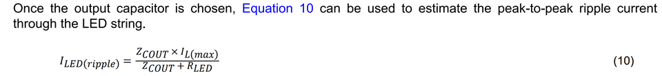

3. Equation (10) in section 9.2.1.2.3 "Output Capacitor Selection" does not contain the value of the chosen capacitor while it probably should. Likely it is a mistake. Please clarify.

    1. This diagram is correct. As is mentioned in the datasheet, the 100nF capacitor is used for high-frequency filtering of sense feedback. The C_SENSE is a ceramic capacitor with relatively large capacitance to suppress the ac magnitude of sense feedback less than 200 mV (If this large capacitor is missing, you will get a zero sense signal when the internal switching FET turns off and no current flows through the current sense resistor).
    2. In equation (8), the I_LED(ripple) is the LED ripple set by your system spec requirements. You follow this requirement to design the C_OUT theoretically with Equation (8). After you choose your real C_OUT value, you can then estimate the I_LED(ripple) that you will get with this real C_OUT value by using Equation (10). For I_LED(max), yes and there should be one equation. Thanks for pointing out this to us.
      1. For boost topology, you can calculate I_L(max) with I_L(max) = V_OUT * I_LED(max) / efficiency / V_IN.
      2. For buck-boost topology, you can calculate I_L(max) with I_L(max) = V_OUT * I_LED(max) / efficiency / V_IN + I_LED(max).
      3. When you design the components at the first time, you can estimate a value for the efficiency (like 85%) and use that for calculation. You can later adjust the components based on your test results.
      4. You can take a look at this E2E thread for reference.
      5. There is a mistake in the datasheet sentence "KIND is a coefficient that represents the amount of inductor ripple current relative to the maximum LED current". It should be correct as "KIND is a coefficient that represents the amount of inductor ripple current relative to the maximum inductor current"

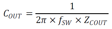

    3. You Can calculate C_OUT with this equation.

    I was more wondering if the 100nF capacitor could be omitted, but I guess it should be there.

    Normally I would recommend customer place that 100nF capacitor between CSN and CSP pin.
