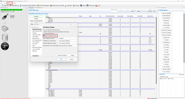

    The command 0x1C is a read command so you are not able to write a new value using that command. If you want to change the "Serial Number" parameter you should make that change in data memory. In BQStudio, if you press Window, then preferences. Then under "All Global Settings", check "Show Advanced Views".
    Now, you can see the physical starting address for the data memory parameters. "Serial Number" is in the SBS Configuration tab in Data Memory. Using the physical starting address for Serial Number, follow the steps in this E2E post on how to edit data memory parameters using advanced comms tab. Then you can sniff the communication lines to see exactly what's happening to replicate on your system. https://e2e.ti.com/support/power-management-group/power-management/f/power-management-forum/1333721/bq28z610-bq28z610-change-utd-fail
