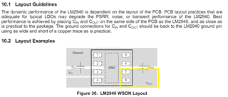

LM2940-N: pin numbers of WSON (NGN) Package are different in Layout example on data sheet
Part Number: LM2940-N
      The data sheet in pin numbering table suggest that pin numbers for Voltage output are 5 and 6 for WSON (NGN) package but the layout example is suggesting 7 and 8 are voltage outputs.
Can you please confirm which one is correct?
Also, can you please suggest that N/C pins can be connected to GND as shown in layout example.
