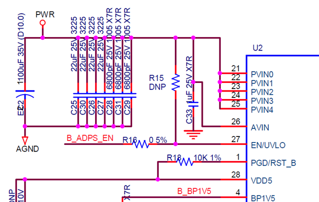

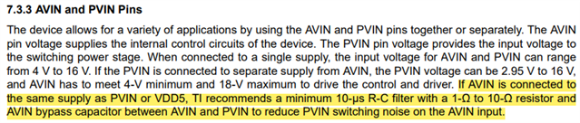

Q1) On the datasheet, “If AVIN is connected to the same supply as PVIN or VDD5, TI recommends a minimum 10-µs R-C filter with a 1-Ω to 10-Ω resistor and AVIN bypass capacitor between AVIN and PVIN to reduce PVIN switching noise on the AVIN input." It says.
If there is no R-C filter configuration as in the circuit below, will this be the cause of the current problem (short between sw pin and PGND pin)? (U2 is TPS546D24A)

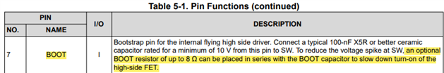

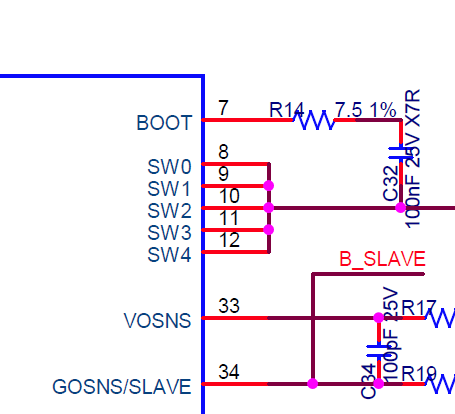

Q2) There is the following phrase regarding "BOOT" in the datasheet.
If the resistance of the Bootstrap value between SW and BOOT is 7.5 ohm as shown in the circuit below, will this be the cause of the current problem (short between sw pin and PGND pin)?
    It is unlikely that failing to filter the PVIN to AVIN connection would result in damage to the low-side MOSFET and the SW to PGND node.  The primary purpose of this resistor is to limit switching frequency noise on PVIN from affecting the analog control circuitry powered from AVIN.
    A boot-strap resistor of 7.5V is large, and could be resulting in a long turn-on time or an extended turn-off time.  If the high BOOT resistor is causing the BOOT to SW capacitor voltage to be low, it could result in an extended high-side driver turn-off, which could result in cross conduction and low-side MOSFET failure.
    Monitor the SW and BOOT voltage with respect to the same ground point with the same vertical resolution at 1 or 2μs per division to check the BOOT to SW voltage and the falling edge of SW at 100ns or less per division to look for evidence of cross-conduction.
