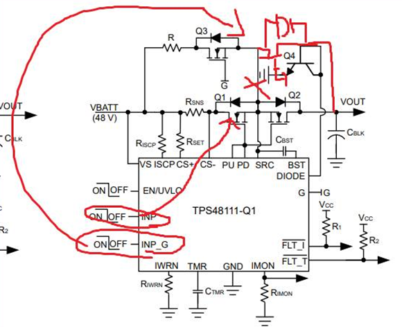

I would like to check if TPS4811-Q1-G Pin can be Discharge PATH?
The 2nd question is that please see below structure, can I use INP and INPG to control back to back MOS?
Thank you

Hi Yeh,
Rakesh-> you mean discharging from VOUT to VBATT ? yes, it should be possible.
What is the use case ?
Rakesh-> yes INP and INPG can control back to back MOS
The common source of the back to back MOSFETs on both paths should be connected to SRC pin
BR,
Rakesh
