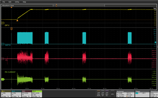

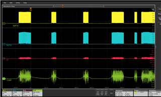

As shown below gate pulses observed in our power converter during startup with no load condition. We operating in peak current mode control, Could you clarify on CH-3 & Ch-4 PWM output nature?
In PSFB , we should get 50% fixed duty at primary side right. Could you help us out?
CH1- QA gate , CH2-QB gate , CH3 - QC gate & CH4 - QD gate.
    The A and B gate driver pulses are synchronized to the master clock with 50% duty cycle.  The C and D gate drive pulses are at 50% duty cycle and are phase shifted to achieve duty cycle.  However, a cycle by cycle current limit can cause the C and D pulse to be phase shifted to demand 0% duty cycle.  This will cause the Out C and Out D pulses to look to be >> 50% and/or << 50% duty cycle.  I believe this is what you are observing.
    You can verify this by studying OUT A, OUT D, CS and comp or OUT B, OUT C, CS and comp.  If the CS signal goes above 2 V the converter will be cycle by cycle current limiting.

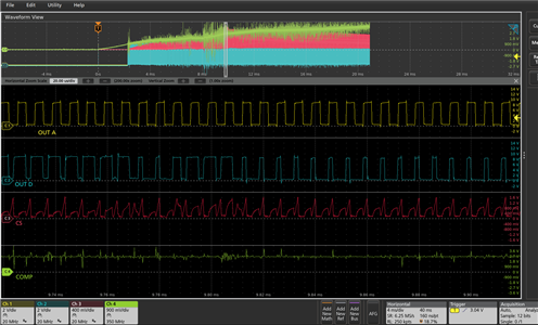

  • Hello Mike,
    It seems CS measurement within limit as attached below images, But lot of variation observed in COMP node.
    Your inquiry is under evaluation and I will get back to you shortly.
    Your current sense transformer signal does not look correct.  It should be symmetrical every cycle.  Your signal is trapezoidal then triangular.  This incorrect CS signal is causing the OUT D to be less than 50 % D sporadically.  The UCC28951 is actually OUT D and OUT C to correct the duty cycle based on the CS signal compared to the COMP voltage.

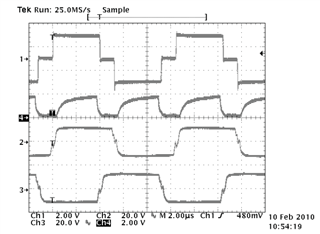

    The following waveform shows the voltage across the input of PSFB transformer (CH1) and the voltage at the CS pin (CH4).  This is what the current sense waveform should look like.  I think you might have an issue with how your current sense transformer is setup. CH2 is the voltage at the gate of QA and CH3 is from the voltage at the gate of of QD.  These waveforms were taken on a 600 W reference design using a 2 to 1 gate driver transformer to drive the FETs on the H Bridge.

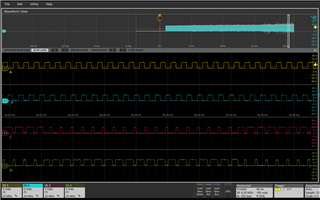

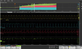

  • Hello Mike,
    As per previous thread measurement taken with 100 ohm load. We will just Ignore for a moment.
    Refer following images for no load startup , even though CS signal less than 0.2V , still observing Out D duty variation, Anything are we missing here.
    I was busy answering our other thread and will look into this thread for you tomorrow.
    Your current sense transformer signal does not look correct.  It should be symmetrical every cycle.  Your signal is trapezoidal then triangular.  This incorrect CS signal is causing the OUT D to be less than 50 % D sporadically.  The UCC28951 is actually adjusting OUT D and OUT C to correct the duty cycle based on the CS signal compared to the COMP voltage.
    The following waveform shows what the current sense signal should look like (CH4).

  • Hello Mike,
    As you mentioned CS signal affected because of CT secondary reset resistor kept around 100Kohm. After modifying that with recommended value,100 times of Rsense.
