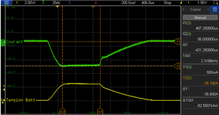

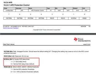

We observe that the ASCD threshold 1 delay is greater than the requsted value. ASCD Th1 = 0x31, with delay = 183 µs.

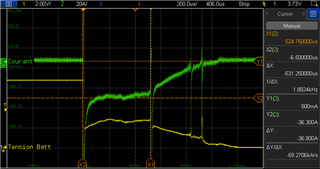

We measure a detection time = 531 µs instead of 183 µs.
Can you explain why we don't have the right delay?
With the retry we have also a delay = 431 µs
