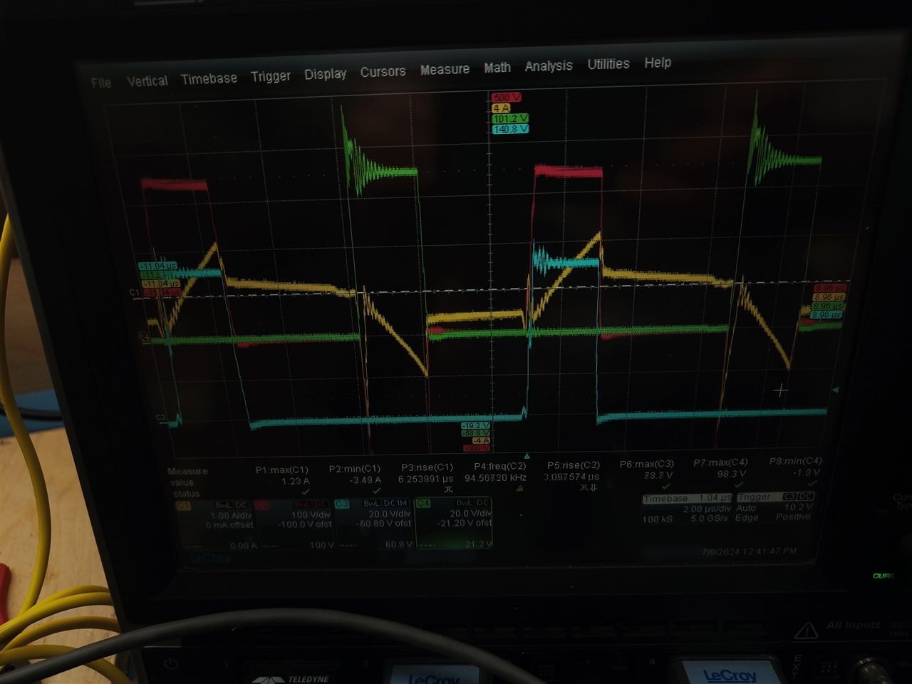

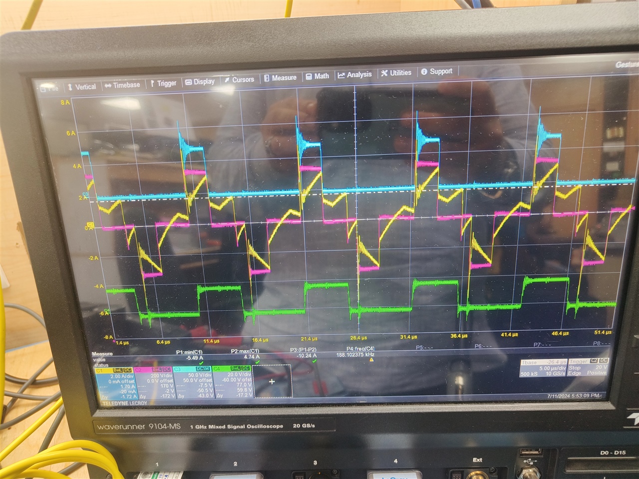

Q2. When going higher voltage or when it's tarts to regulate around 140V and higher ... Transformer current starts to shift negative during the positive  edge. For low voltages low load currents it all looks ok, transformer current remains symmetrical across zero crossings. Is it something to do with compensation or duty cycle ? Or is it something different? Please advise.
Yellow : transformer primary current
Blue and green : secondary side FETs
Green : transformer primary voltage

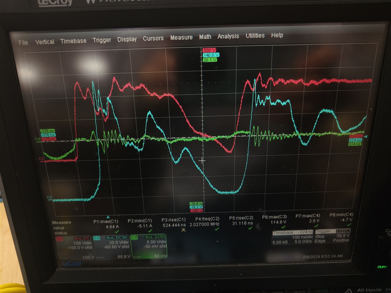

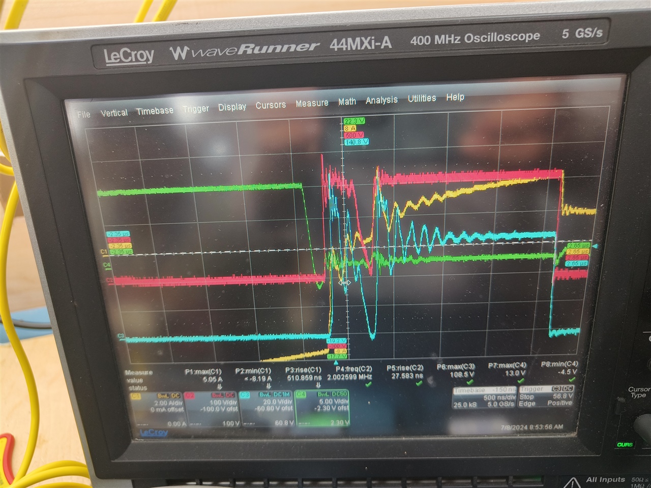

Q3: continuing above problem, Additionally transformer voltage drops momentarily and rises again during higher voltages / higher currents as seen in below image.
Red : transformer primary
Blue : one of secondary side FETs drain source
Zoomed out version of above image is below. one of the Synchronous FETs gate in green which turn oFF and then this happens. Is it something to do with reverse recovery of FET diode ? Your thoughts please.

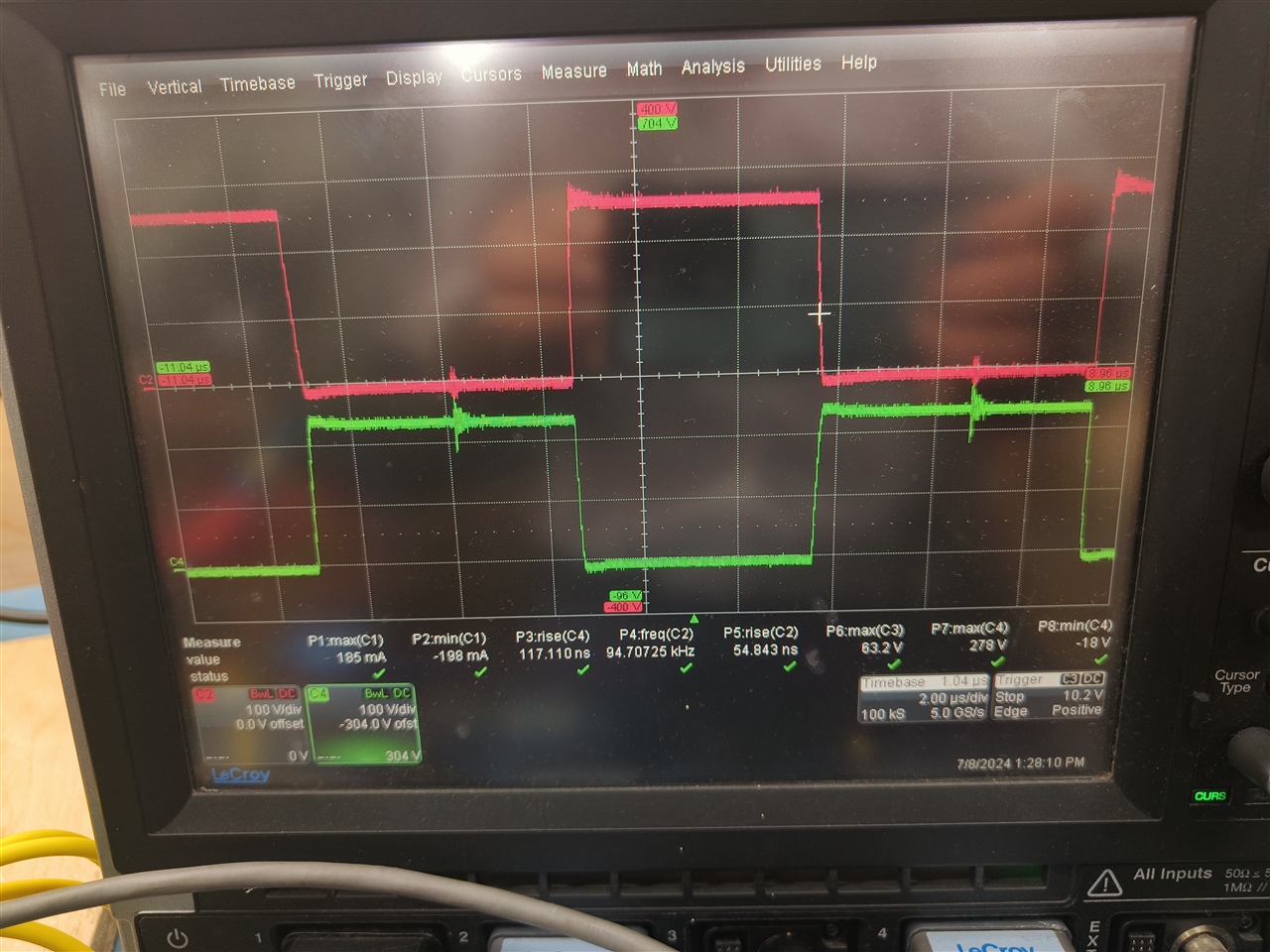

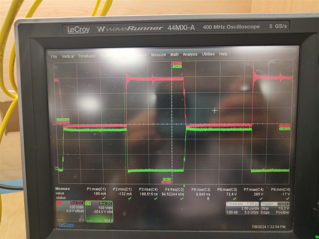

Q4. Also I noticed with introduction to gate drivers , below are gate waveforms primary side switches.
FYI, DELAB : 30K,  DELCD: 30k, DELEF:15k
A& B waveforms:
C & D waveforms :
Rise time is different, worst in case of A & B, which I have observed causes a delay in transformer primary voltage postive side, the rise of transformer primary voltage looks slanting and doesn't look sharp which in turn effects secondary side FET also.
    > The transformer current will change direction based on the voltage applied across the transformer and it should be symmetrical.
    > What could cause you issues it the leading edge current spikes.  These should not be there.  The timing of your SR FETs may be off.  Try disabling the SR FETs and using the FET body diodes to see if this goes away.  If it does you will just need to adjust the SR FET timing.  The application note previously referenced gives guidance on how to set the SR FET timing.
    > If the controller voltage across the transformer is dropping as the voltage is increasing the UCC28950 is going into over current protection hiccup mode or light load burst mode.
    > Section 7.3.14 in the data sheet will describe how over current hiccup mode protection functions.
    > Section 7.3.9 explains how light load burst mode works.

    In your waveforms it looks like the converter is entering light load burst mode and/or over current hiccup mode protection do the leading edge current spike in the transformer.  I have the following recommendations.
    1. Review your design with application note SLUA560D and excel design tool.
    2. Order evaluation module UCC27714EVM-551 for evaluation.
    3. Review the user's guide for schematic, layout example and critical waveforms.
    4. Check your transformer turns ratio to make sure nominal duty cycle at all input conditions is > tmin*fsw.
    5. Check your current sense transformer and current sense resistor to make sure they are setup and selected correctly.
    6. Disable SRs to see if the SR timing is causing the leading edge current spike.  This can be removed by properly setting up FET E and F turn on timings.  Application note slua560d will show how to setup the timings.

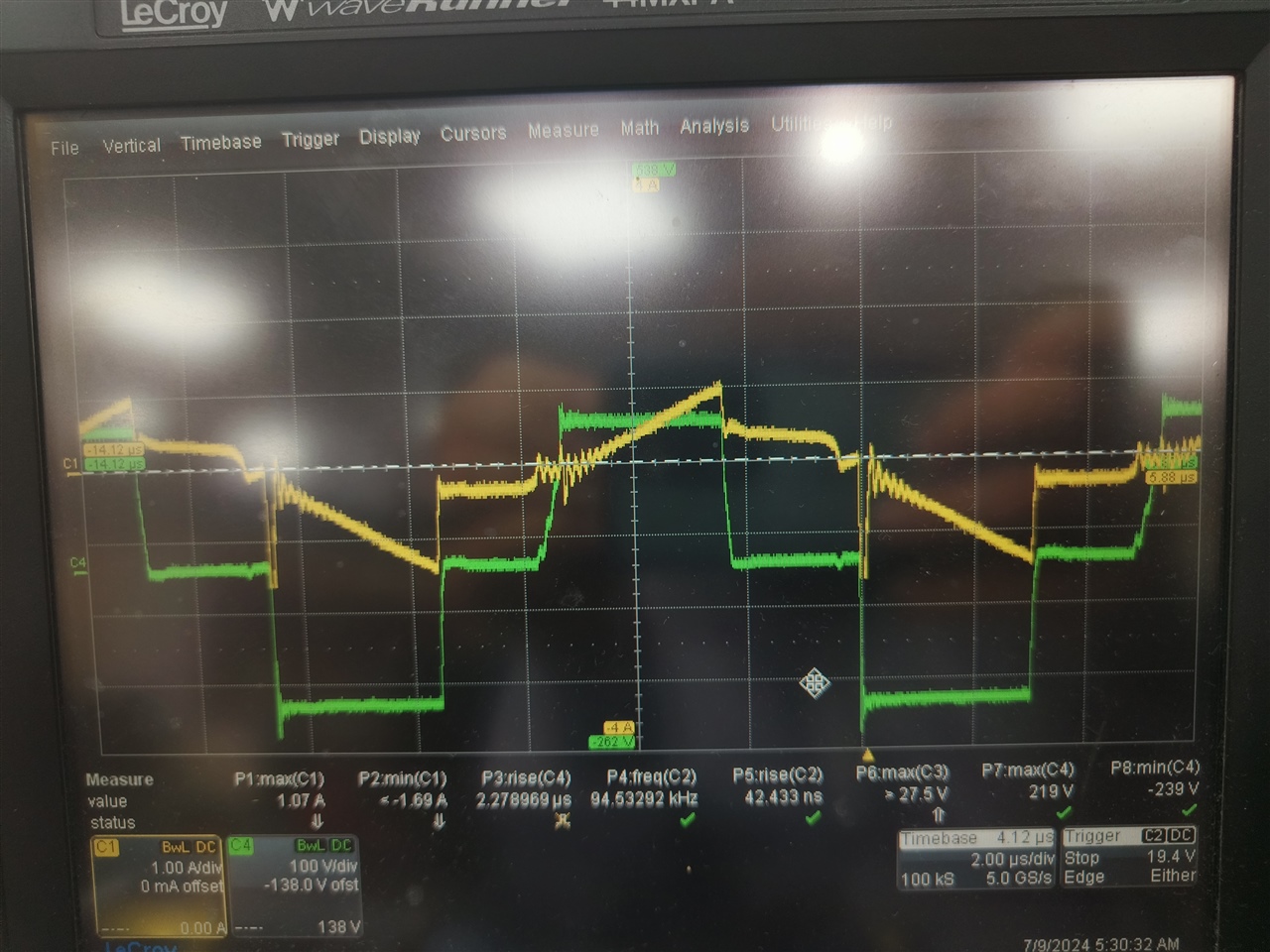

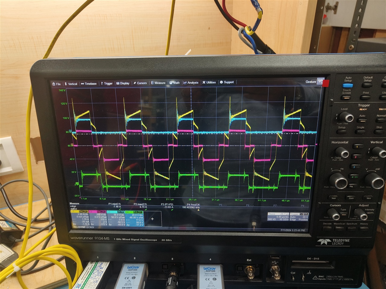

  • Below are current waveforms. Are these Ok ?
    DELAB, DELCD: 51K, DELEF : 30k
    Yellow: transformer primary current
    Pink : transformer primary voltage
    1. Vin :200V, 40A
    2. Vin : around 400V, 20A
    3. Also with higher input voltages more than 400VDC, SOme kind of short dip is observed during freewheeling ( flat region , pink colour), how to mitigate or avoid this ??
    4. Additionally I'm planning to use hall sensor in place of CT, any relevant circuit design available? What are all the design aspects I need to take care of ??

    What did you do to change the transformer primary current waveforms?
    The primary transformer current still does not look correct for a phase shifted full bridge.
    The following link will bring you to an application that has a figure of what the primary current of the transformer should look like for a PSFB.  Figure  4-1 in this application note shows what the transformer primary current should look like.
    https://www.ti.com/lit/an/slua560d/slua560d.pdf
  • This is happening with changing DELAB DELCD DELEF ... AND with increasing voltage I suppose. Can we keep these delay resistance constant for vin from 200V to 600V ?
    As  per my understanding it's difficult to attain with fixed delay approach if Vin keeps varying. Your thoughts and guidance ??
    Your inquiry is under review and I will get back to you shortly.
    There is something wrong in your application of the full bridge.  The transformer primary current does not look like it should in a phase shifted full bridge application.  Before adjusting the delay timings you need to figure out why the transformer primary current is not as expected. The transformer primary current (Iprimary) should look as presented in the waveform below.
    The following link will bring you to an application note that goes through the step by step design process of a PSFB using the UCC28951 controller.
    There is a schematic of a 600 W reference design in figure 15-1 and 15-2.  I would compare the schematic to your design and correct any differences that you might see.  https://www.ti.com/lit/pdf/slua560
    Once you have the design behaving as excepted you can then use application note slua560 to set the delay timing.
