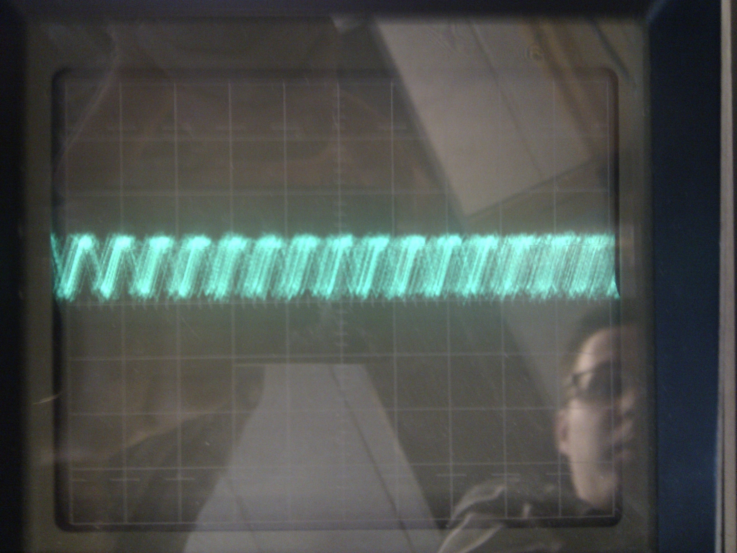

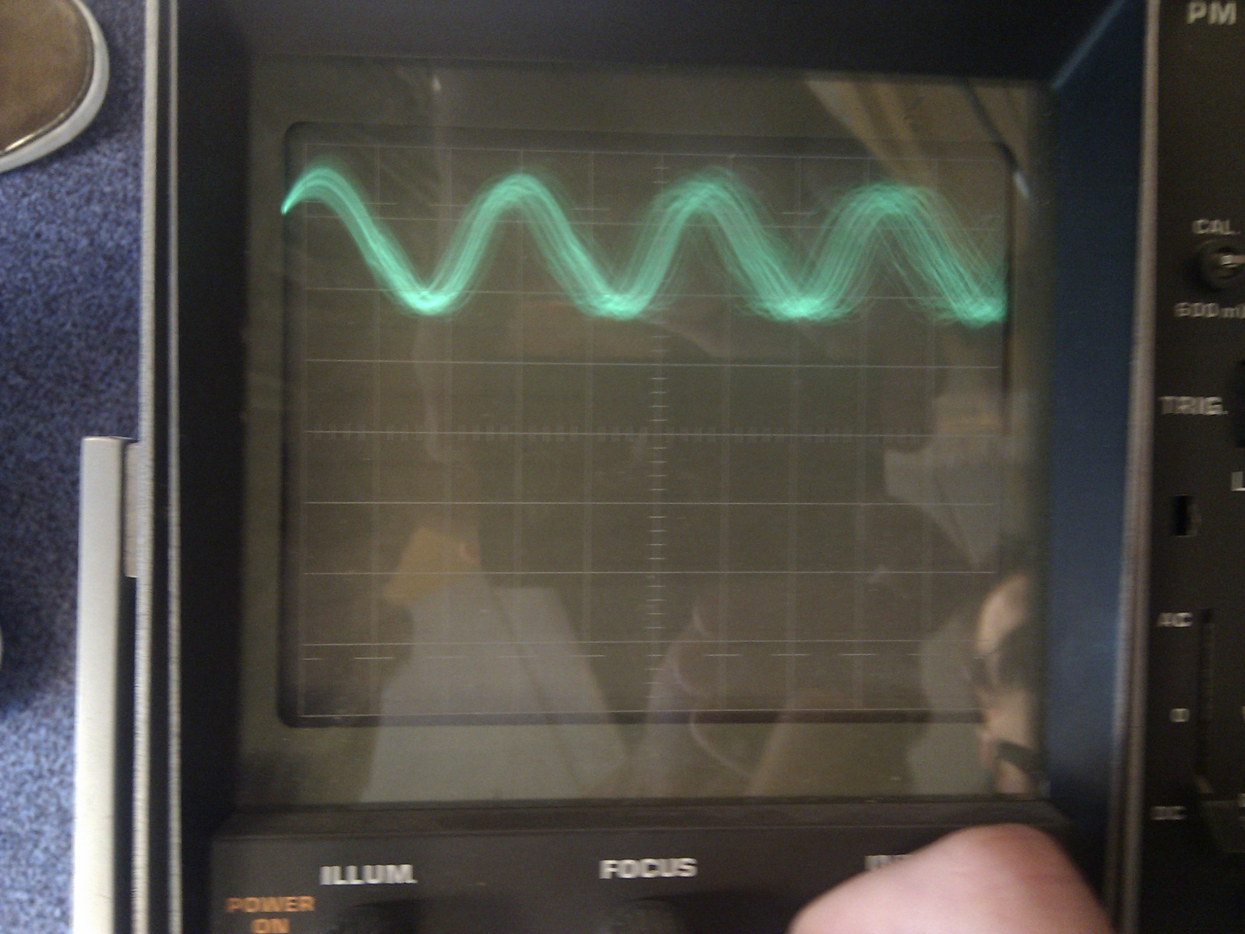

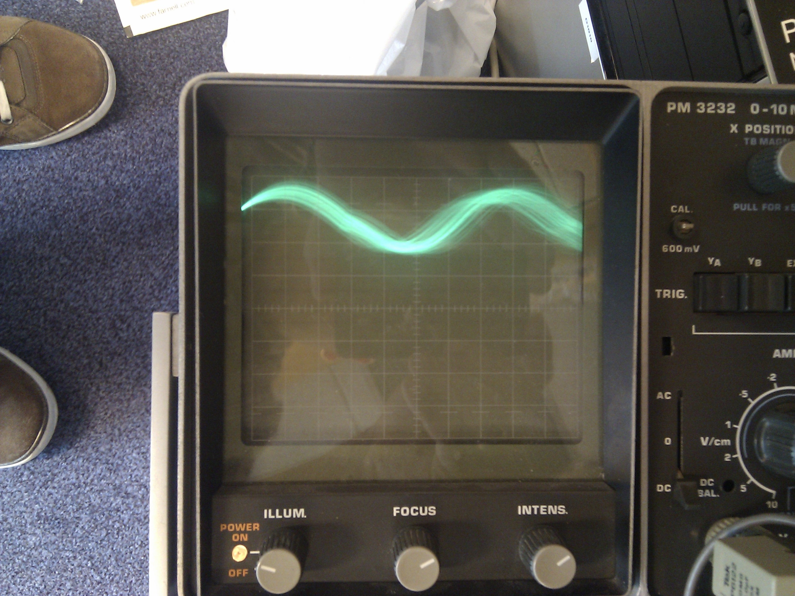

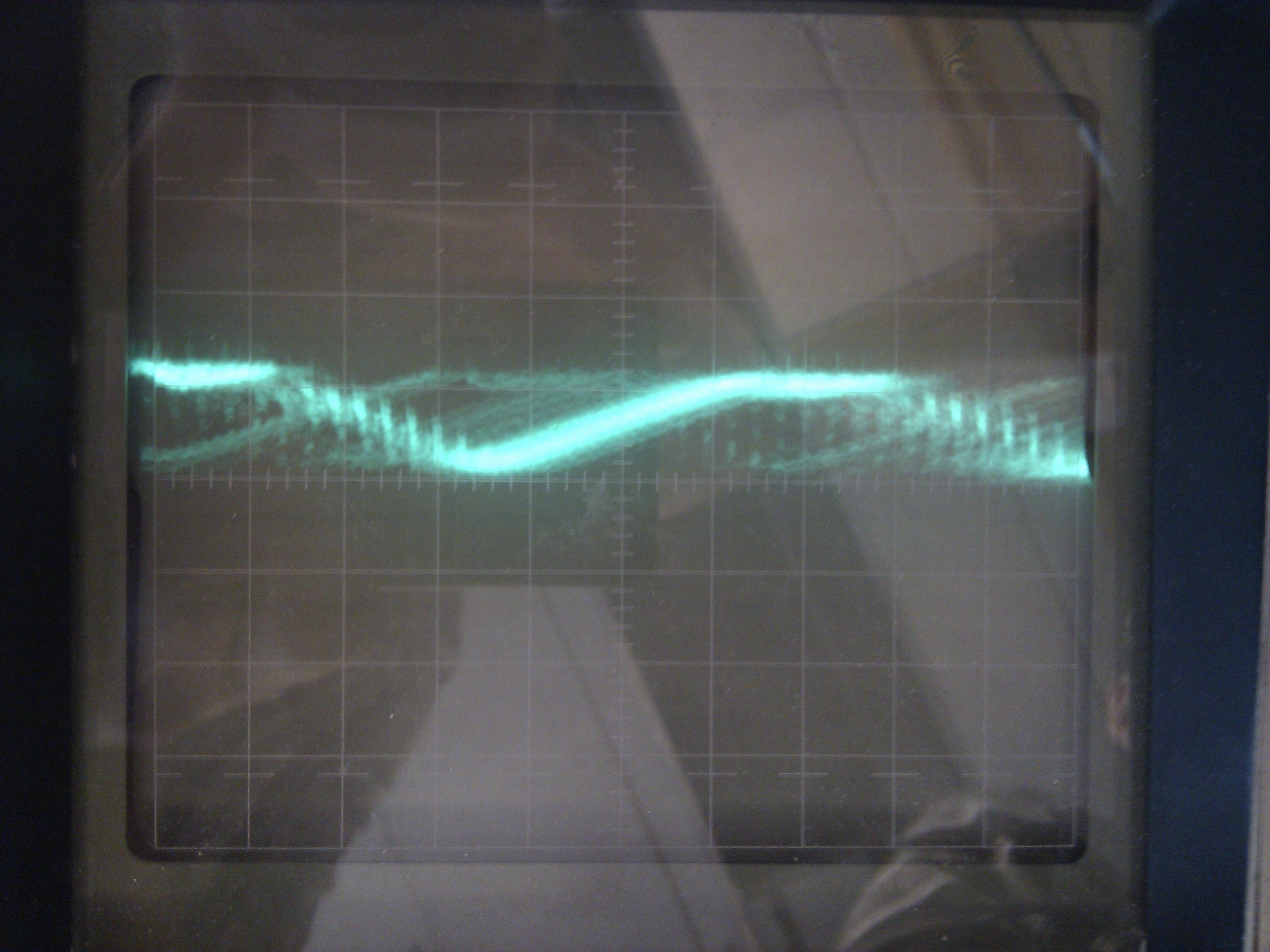

  • TPS54620 1.2V supply:
    I have bypassed the 12V supply so I can start testing the 4 TPS54620 supplies. This on a non-modified proto with f_sw=182khz.
    3 out of 4 are ok (if I put 3v3 on the EN inputs).
    The 1V2 supply however shows oscillation on its output, and the powergood is continually asserted/deasserted.
    I measured the level on the SS pin with a scope and it is stable 1.9V. So the device is not restarting due to thermal overload or UVLO.
    The output level is a sinus between 0.8 and 1.8V with a frequency of around 7kHz.
    What can be the cause that the other 3 supplies (which use the same layouts) are Ok, while this one oscillates?

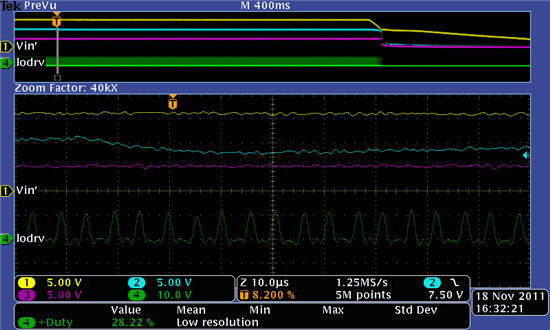

  • TPS40054 12V Supply:
    With little load: the output goes up to 12V and then drops to 0V again, with a frequency of about 1 Hz. SS pin rises to 1.0V (in 50ms) and then drops to 0V again.
    With 1.5A extra load: the output is steady at 10V. SS pin is at 1.9V.
    So no clear oscillation. Trying a 40055 will take some more time, but will this help as there is no oscillation to be seen?

  • I can see a couple issues.  First is your clock circuit.  I recommend that you terminate the RT/CLK pin at each TPS54620 with a RT resistor for 200 kHz operation.  Each TPS54620 should have its own buffered clock input.  Try disconnecting you clock input and use an RT resistor to see if your 1.2 V rail comes up.
    The compensation is a little conservative, but the circuit should be stable.  The inductor value in switcherpro is large (it calculates based on the output current, it should be ok, but we may want to try something smaller).
    can I see some waveforms?
  • Disconnecting the clock from the RT pin is almost impossible as it is connected to a via very close to the pin. Besides that it would be very strange if the clock signal is the problem as both the 3.3V and 1.2V supply use the same clock, as you can see in the schematic 7462.supplies.pdf (bottom left is the 3.3V supply, bottom right is the 1.2V supply) and the 3.3V rail is ok.
    Increasing the clock frequency can be done quite easily, would you like me to try that?
    Of which points would you like to see waveforms? I only have an analog scope here, so I'll snap some photos of the screen if that's ok.
  • The TPS54620 is designed so that it should start up using the RT current to start the internal VCO and then transition over to the external clock whne the PLL locks onto the clock signal.   I cannot say for certain what mechanism may cause a problem, but I had to point out this design issue.  Can I assume the external clock is stable and running before the 1.2 V rail is enabled?
    Take any waveforms that show your problem. Be sure to show the PH node, and take both wide time scale and zoomed in shots.  It would also be good if you can measure the inductor current with a current probe and loop of wire.  Also you could try measuring the loop to see if it is stable.  What is the load?  Is there a lot of capacitance that is not shown?

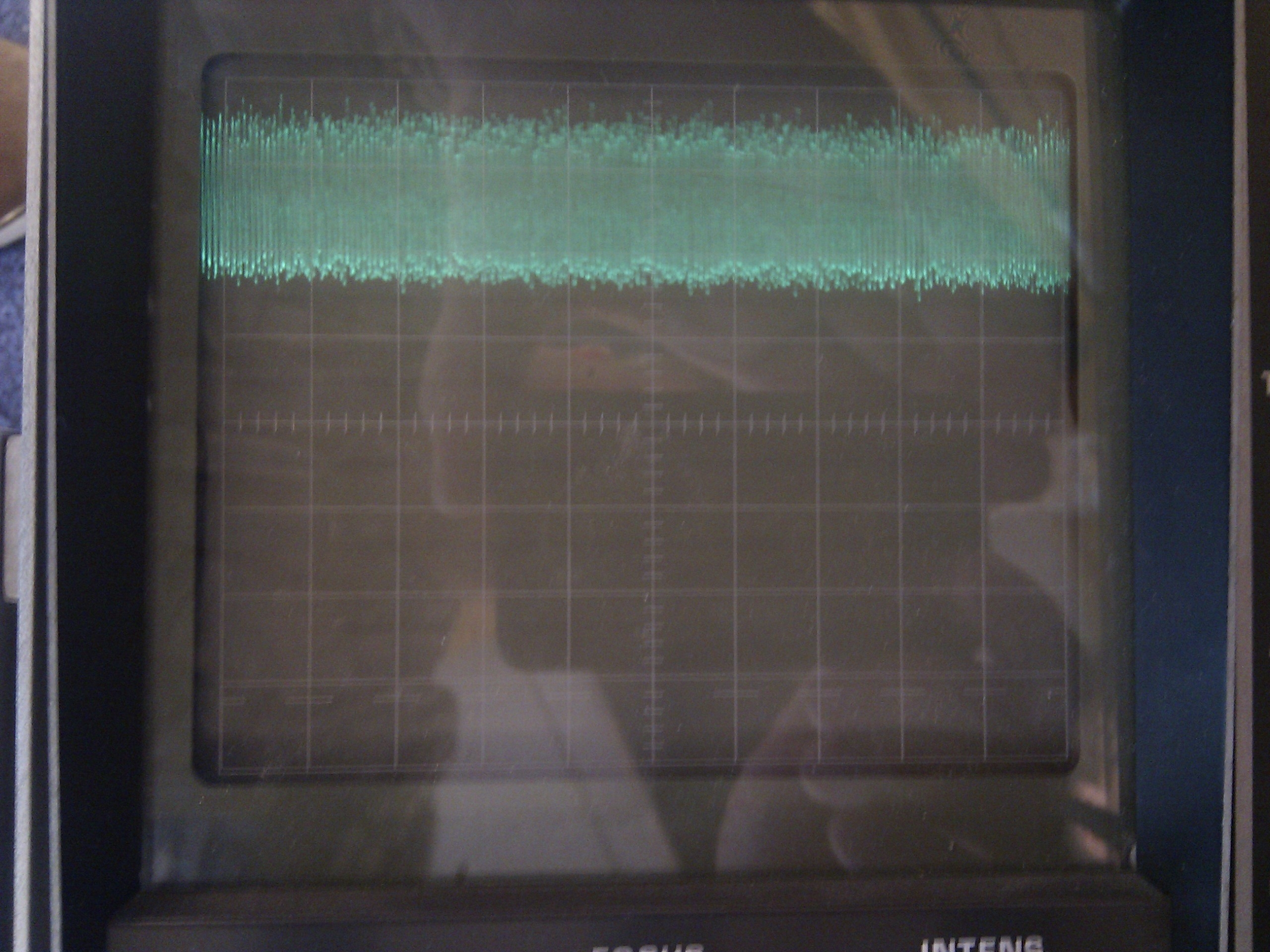

  • Vout 500mV/cm 20uS/cm:
    Vout 500mV/cm 50uS/cm:
    Vout 500mV/cm 2mS/cm:
    PH 100mV/cm 20uS/cm:
    PH 100mV/cm 200uS/cm:
  • To be certain that the 180kHz clock was not the source of the problem, I increased the clk to just above 200kHz. The 1.2V supply symptoms stay exactly the same.

    • Does the TPS40054 require a minium load to properly maintain its output level? For DCM operation, the double-pole of the power stage in CCM will split to two poles. One dominant pole at lower frequency and another pole at high frequency which can be neglected. So the compensation network for CCM may not work well at light or zero load.
    • With little load: the output goes up to 12V and then drops to 0V again, with a frequency of about 1 Hz. SS pin rises to 1.0V (in 50ms) and then drops to 0V again. The SS pin can only be pulled down if one of the following conditions is met: UVLO, OC, thermal shutdown. Can you capture the waveforms of Vin, Vout, SW along with SS right before the SS starts to drop?
    • With 1.5A extra load: the output is steady at 10V. SS pin is at 1.9V. It seems the output is out of regulation. Possibly, (1) the regulation point is far away from where the load is connected; (2) the part runs at maximum duty cycle. If it is because of (1), from the pcb files, could you indicate where are R240 and C283 connected to the output and where the 10V output is measured? If it is due to the maximum duty cycle, the waveforms of Vin, Vout, SW and HDRV will help to debug the problem. You can also read the app note SLUA310 for more information. But I doubt that with the mentioned input/output voltage, it runs into maximum duty.
    • So no clear oscillation. Trying a 40055 will take some more time, but will this help as there is no oscillation to be seen? From the phenomenon seen at light load, it might be caused by the loop. You may modify the loop design or simply change to TPS40055 to confirm.

  • Concerning the TPS54620 designs:
    I changed the loop compensation to a type III compensation and recalculated the supplies using the excel-sheet instead of switcher pro. Those 4 supplies are now stable with load-step behaviour as calculated with the excel-sheet.
    One question remains though: Why doesn't switcher pro suggest a type III compensation, as from what I've read the only drawback might be one component extra?

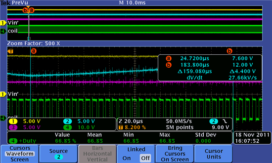

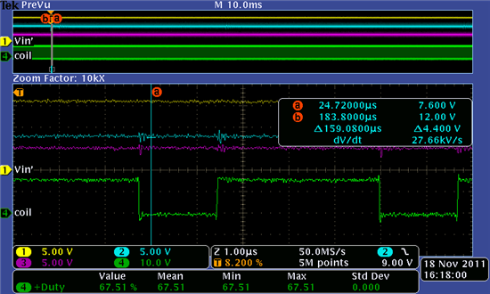

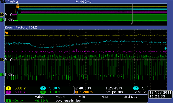

  • Concerning the TPS40054/TPS40055 design:
    As suggested I changed the TPS40054 to a 40055. This improved light load behaviour and the part is stable now.
    There is however one issue remaining: the load-step response seems not good to me

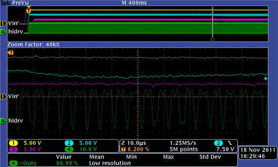

    Testing with 16V input, when a load-switch is enabled and capacitor inrush follows, the output voltage drops to  7.6V and it takes 160us (32 clock cycles) to reach 12V  again. What worries me is that I see no duty-cycle increase, it just stays at 66.85%. See scope images below.
    Is this behavior as expected. If so I will need to add more output buffer capacitance.

  • Hi Marijn,
    As explained in the app note of SLUA310, the maximum duty cycle at a given input voltage is Dmax = RKFF x DV x C/(0.1 x (VIN - 3.5V) x tsw).
    Sorry, I need to modify my statement: tsw here should be the sync frequency.
    The typical value of C is 13.5pF. However, this value is not trimmed. We looked into the design, it may have +-30% process variation from chip to chip. Taking this into consideration, the maximum duty cycle could be
    Dmax = 237kohm x 2V x 13.5pF/(0.1 x (16V - 3.5V) x 1/200kHz) x 0.7 = 70%
    Therefore, the value you have seen is reasonable. As you mentioned, you could increase the output cap and/or decrease the inductor to help the load transient.
