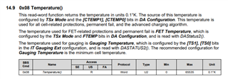

    If possible, can you please try reading out the temperature reading from the 0x08 function? I would like to see if this reports the same 35.15 internal temperature that you are seeing from the DAStatus2().
    Anthony Baldino

    From DAStatus2()
    SMBus Read 17 bytes, Slave = 0x17, Reg Index = 0x23, PEC = Off
    0x10, 0x6f, 0xb, 0x72, 0xb, 0x6f, 0xb, 0xc9, 0x12, 0x6b, 0x12, 0x72, 0xb, 0, 0, 0x72, 0xb
    From 0x08
    SMBus Read 2 bytes, Slave = 0x17, Reg Index = 0x8, PEC = Off
    0x72, 0xb
    0X0B72 = 2930 = 293.0 K = 19.85 degrees C
