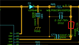

Hi Zhiqian,
Please review the schematic with LP8868Y-Q1?

Hi, Joey
Pls see my feedback in below:

Hi Zhiqian,
Please review update schematic and recommend removable device on the schematic and value as well.

HI, Joey
I find the OVP resistor is 30k/20k, it is doesn't match with the design, for buck-boost topology, the OVP threshold needs to consider as VIN+VF. Other is fine.
Hi Zhiaian,
What value of Resistor are you recommend for OVP resistor?
If you have LP8868Y-Q1 calculator sheet, please share it with me.
