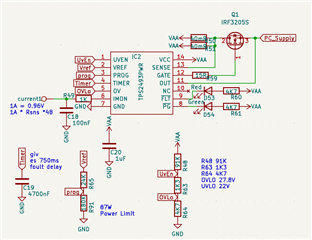

hi,
i also have a problem with my TPS2493PWR its stange behaviour at least thats what i think of it but i am still learning bits so i am curious to your findings.
i have a tps2493 i was testing the features to see if the circuit is good.
all was great until the output short circuit test.
at around 20-21V the current limit state is constantley on. e.g. i am burning 21V0.6A (12W) trough my fet. its heating up way too fast.
i ahve a 1uF cap on timer why does the output not switchoff at 160ms?
the stange thing is above the 21V it works fine...
can you look at my schematic and see if i made a miscalculation somewhere?
is the behaviour at 20-21V normal? what could i do to make shure the fet is not burning up as fast?
looking forward to your findings,
BR.
michel datema
  • Hello Michel,
    You have set UVLO at 22V as mentioned in schematics.
    For the FET to operate in saturation mode, VIN must be higher than UVLO set.
    Amrit
    I dont really understand what you mean by that.
    Uvlo is 22 at vin of the resistor devider. At the uvlo pin is 1,25 (or so) volt.
    E.g. the vin is always higher as uvlo.
    Is this what you ment?
    The fet works from 2-10v at the gate. Absolute maximum voltage is at 20v according to the datasheet.
    I have a theory please help me think: what is the short circuit draws so kutch current that the voltage on the input drops under uvlo level. That the ic switches off. Voltage rises and over again. I am going to check these levels with the scope. Ill update later.

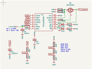

  • i am doing following tests:
    Nominal load, overload, open load and short circuit.
    and on tests where there is a load ivolved the problem occurs at around 21V the turn on voltage from UVLO.
    i dont think you need to replicate but i do need some help.
    since my last tests i changed the resistors connected to PROG. (first with a potentiometer later with fixed resistors)
    this way i was able to work out at what position the problem starts.
    i have no real value i believe it was about 1/4th of the range of the pot.
    now the system works without problems. good startup. swithces of at overload retrys and so on.
    only one problem that concerns me.
    if i change the resistor values in the excel calculator sheet. than i get some red boxes. telling me that i am now at 20% of SOA (SafeOperatingArea) of the FET. i cant get my head around that why. in my head this fet and drive should easily be aplicable for this system
    can you have a look at that? and explain to me what the reason is and even better what i can do to change it.
    i have watched the videos but couldnt really understand where this problem comes from.
    thanks in advance.5582.TPS249x_8x_Design_Calculator_REV_B.xlsx
  • Hello Michel,
    Based on the input values given in design calculator two boxes are coming red
    1.IFET - ILOAD margin (lowest for Vout range) : It's coming red because you have put starting load as 9 ohms which means ILOAD=2.67 A but you have given max current as 2.25A on step-1. Please increase the starting load value at F70.
    2.Derated SOA / PLIM: This is coming red because you have put 1A in 1s or DC SOA Current at @ VIN(MAX) (use DC if 1s not available) and also for 100 msec. Which looks to be wrong. Please use correct value from MOSFET datasheet.
    Amrit
  • hi,
    i changed some values my on resistance is normally about 1Kohm or so i dont understand why i put this not so smart the system wors form 15 Ohm thats good:)
    but i dont understand what you mean. the SOA table i could find but i cant find anything with DC on the table.
    i think i am missing one rediculousley simple detail could you explain to me what the DC value is?
    thanks in advanse
    michel
  • Hello MIchel,
    Please check F58,F59 cell in design calculator.
    Please add the correct the value from datasheet. These were the reason why your Derated SOA / PLIM (F78) was coming red.
    Amrit
