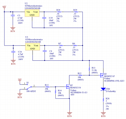

Hello again! I am revisiting use of the LM5156 after having successfully gotten the board to deliver the appropriate power at full load. We are now attempting to use the output of this board to directly connect to and power two LDO's configured as current sources in parallel. The LM5156 appears to be struggling again to provide the desired power. Are there any tips or tricks for chaining these regulators? We have the recommended input capacitance for the LDO's but is it recommended to filter the input? Any tips would be appreciated!
