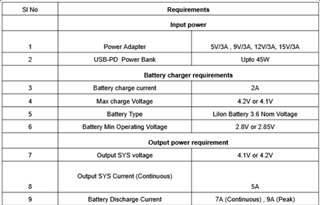

Hi Team,
We are designing a power delivery system with TPS25730D PD Controller.
Our requirements are as follows.
Kindly review our design attached below and provide your feedback.

Hi Binyamin,
I've completed the schematic review and attached my feedback.
Kind regards,
Conner GilletteVVDN_730_review.xlsx
Hi Conner,
Thanks for your response.
Also suggestions regarding the ADCINx Values have been noted.
