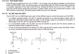

TPS65216: What is the recommendation for PB pin (Push Button Reset) in Non-portable Systems ?
Part Number: TPS65216
In Datasheet section 5.3.1.13, requirement for AC_DET is clearly mention for Non-portable Systems.
But section  5.3.1.12 or at any place we could not find the recommendations for PB-pin for Non-portable Systems.
Can you please recommend  the status of PB-pin for Non-portable System?
FYI : We are making AC_DET = 1 and PWR_EN = 1
