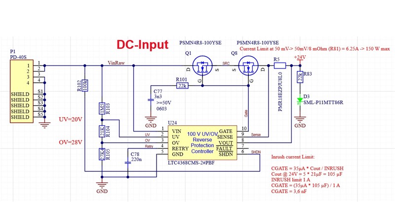

Find relevant schematics below:
Vin (24V with Protection Controller)

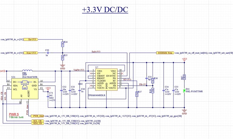

TPSM63606 (24V in , 3.3V out) :
Connection to other board:

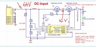

  • Dear Andrew,
    Under- and overvoltage protection is implemented by U24 (LTC4368) .
    U24 does not open FETs Q1 and Q8 if ViinRaw is below 20V or above 28V and so the TPSM63606 do not see more than 28V.
    I tested this by applying up to 64V to P1 (on a board where we removed the shorted TPSM63606) with a bench power supply and measured the voltage at Q1 Pin D and Q1 Pin S.
    While 64V is at Pin D there are only about 0,2 V at Pin S.
    When I turn the bench supply below 26.5 V  Q1 opens and the (remaing 4) TPSM63606 are still alive.
    So I think it Overvoltage Protection works or do you think I need to add Zener diodes?

  • Hi Jan,
    I'm just thinking out loud here. Is there any power on PCB 2 when it's connected back to PCB1? I'm just wondering if the VLDO_in pin is causing our device to be damaged.
    Do you have any spare TPSM63606's to rework onto broken boards on to test anything. I'd like to see VIN/VOUT/SW/VCC voltages when the device pops and during your procedure.
    By the way I checked the layout. It seems fine, although there are some 0 ohm/1 ohm resistors on the EVM that make it easy to disconnect various pins from other pins that would be nice if they existed. Mainly one for VLDO_in and CBOOT.
    Andrew
